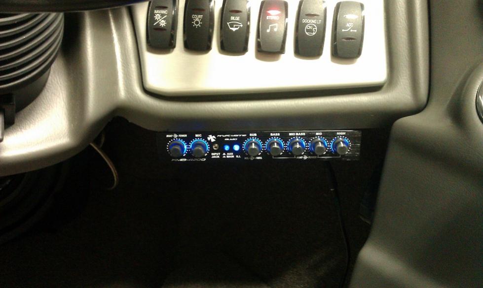

    I'm pretty sure this HU has only one set of preamp outs. The plan is to locate the KMA4200 at the helm and run from the preamp outs on the HU to its input then back to the amps for in-boats, tower and subw.
