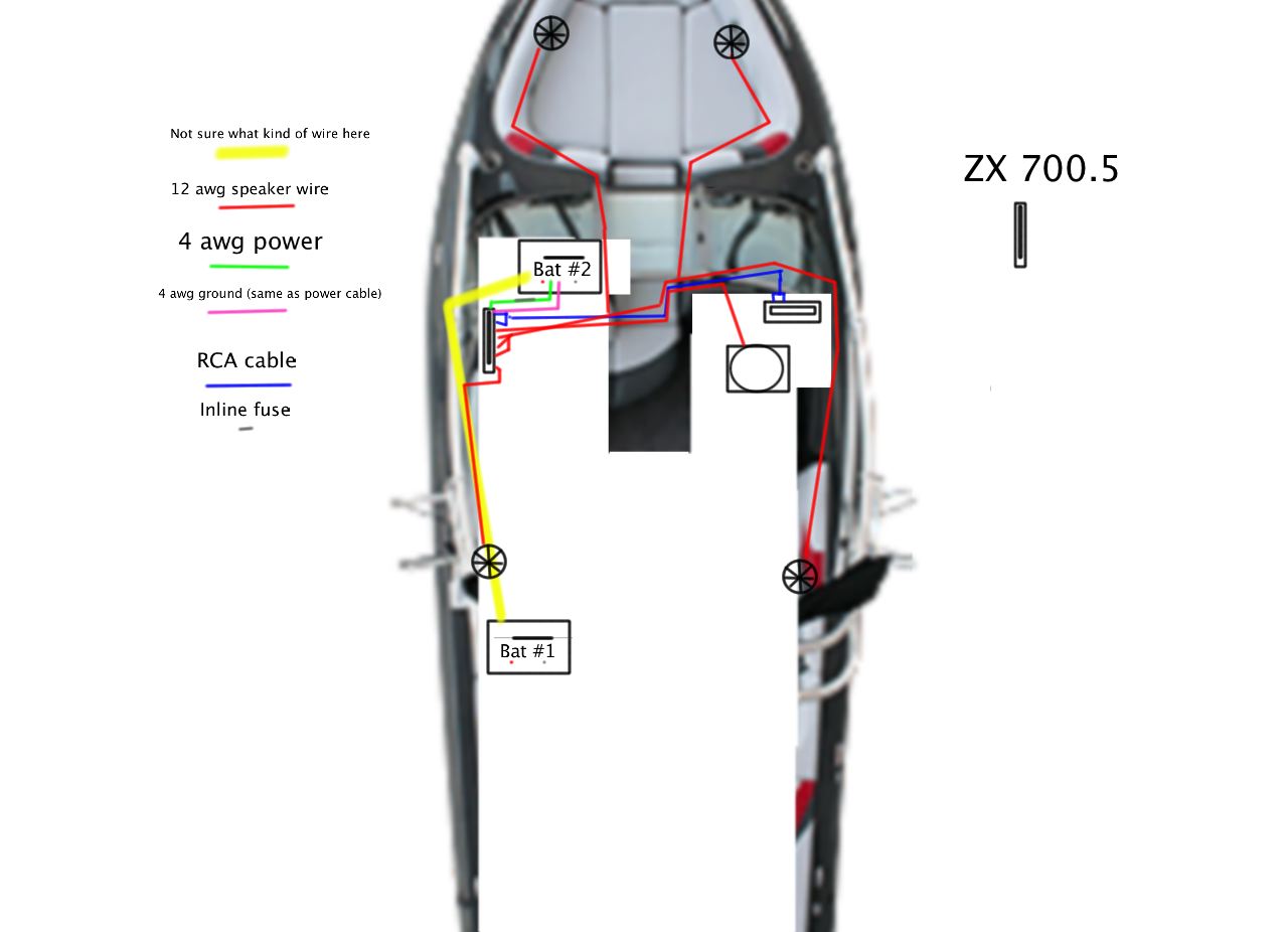

    Here is my first draft of the wiring. I was bored and needed to have a visual Let me know if I missed anything. Have started scoping out the products:
    4 Guage Power - 2x (still looking for better deal) http://www.amazon.com/Lanzar-LQ44-Co...7022329&sr=8-2
    100 ft 12 AWG speaker wire (thinking 50 wouldn't be enough)- http://www.monoprice.com/products/pr...seq=1&format=2
    35 ft RCA - http://www.monoprice.com/products/pr...seq=1&format=2
    Remote Wire - http://www.amazon.com/18ga-Remote-Wi...7023065&sr=1-1
    Few more questions
    1. Power to head unit provided by amp, correct?
    2. What is the remote wire, does that just power everything on when the head unit is powered on?
    3. I am assuming the 12 awg is good since some of the nicer speakers have those as inputs and you can just add the caps/plugs to them?
    Berg- do you run the front bow speakers and right speaker through those holes in the basement? Why 2 cable organizers in that picture? Not enough room, do they run to the same place? Hard to picture where that hole comes up to since I haven't seen our boat in awhile. Does it come up by the drivers feet?
    What kind of material did you use to create the mount for the amps? Was the carpet available locally somewhere? Did you just screw the mounted board then to what is there? Have to make sure the screws aren't too long I suppose.
    BTW Ian if you read this your PM mailbox is full
    Thanks all!

    The drawing looks good. Do you plan on using a perko or just increasing your battery bank size? I think you can do either but I'd verify with someone that you don't need to throw in a perko for some reason. Someone else will have to answer on thickness of run you will have to make. I would typically say 0 awg but maybe you can get away with something smaller since it is such a long run?
    1. Power to headunit is off the little block thing under the helm. It will remain the same and untouched. The only thing you will do at the headunit is disconnect all the speaker wires and plug in RCA's. You may want to post up your head unit. I'm not certain if you need multiple RCA runs. I also haven't looked at the amp. The headunit might have a remote wire location?
    2. Yes, that's all it does. Real small wire.
    3. 12 awg basically future proofs you for future upgrades. If you are going to wire it, might as well do it right once. You would probably be fine with 14 or 16

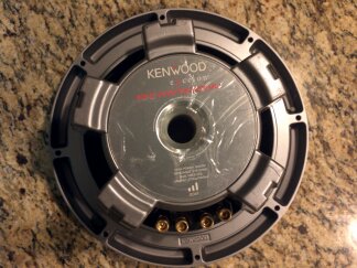

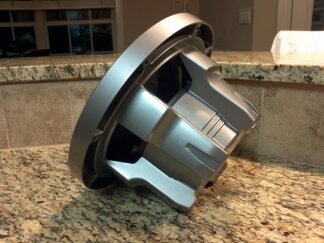

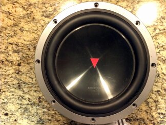

    Quote Originally Posted by ryan_8099 View Post
    Thanks for the info. Do you know the model number on the sub, looking up 10" Kenwood Excelon produced many results with varying price ranges.
    Kenwood KFC-XW1002DVC - 250 rms dual voice coil
    http://www.onlinecarstereo.com/CarAu...XW1002DVC.aspx

    Ryan, I think you will find that putting a stereo in a boat is easier than a car, at least in my opinion. You dont have to remove door panel and such. I cant help much with the second battery idea, I only run one battery in my boat.
    4 guage power and ground wires-with appropriate fuse holder- Good
    35 ft RCA wires- pretty long if you are able to go directly across the boat, might want to measure that prior to ordering, also maybe look for a 4 channel RCA wire. such as http://www.sonicelectronix.com/item_...?from=3-700-53
    12 guage speaker wire, in my opinion might be a little overkill, I used 16 gauge in my application but to each their own- just bought local at wally world, I used 100 ft to run 6 speakers, you may be able to use less.
    Remote turn on wire- 18 gauge. can buy local at fleet farm or similar place. When powered supplied by HU, tells that amp to turn on.
    Bergs pics look like ballast hoses, but if you look behind the hoses you can see the wires.
    For mounting, I also used the seat back in the observer storage area. I used a standard peice of 1/2" plywood, painted it, and covered it in marine grade vinyl.
