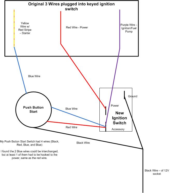

    My push button switch had a confusing wire diagram and color scheme as it had 2 wires the same color and it said to hook 3 different wires up to the ignition. So in case anyone else ends up with a Pivot switch from the internet auction site, here is what my diagram looks like
