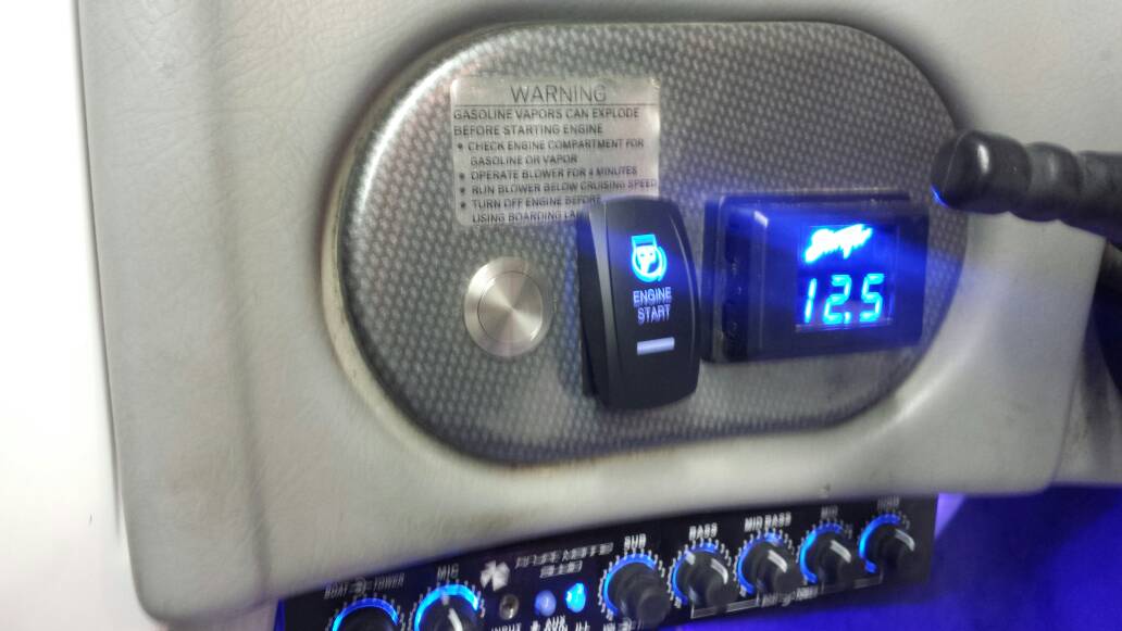

    That looks great Mark!

    Thanks guys, the only thing I might add is a secondary hidden lockout switch.

    Mark - nice man. Very clean.

    Here is my setup.
    Stay awesome!
    • Is the Carling rocker a SPST that is used as a power cutoff (on, then start w/the button and also used to turn the engine off)
    • The button a momentary switch for starting?
    Nice clean install.
    Eric.
  5. #65
    Nov 2009
    2,052
    Yes and Yes.
    -Mark

    That looks killer for sure. My race boat uses the same premise to fire it up, except in an open, non capsule boat my on/off switch is my kill switch which is attached to my racing jacket. I can reach for it easily in an emergency or it come off with me when I am tossed (both ways I have tested). In the capsule boat which I am strapped in a safety cell my on/off switch is a toggle switch with a large cover that makes it easy to shut off in an emergency. So in short you can use an ordinary two position toggle switch and a momentary start button, both of which are available at you local auto parts store. Definitely not as cool looking as the install that was posted, but an option.
