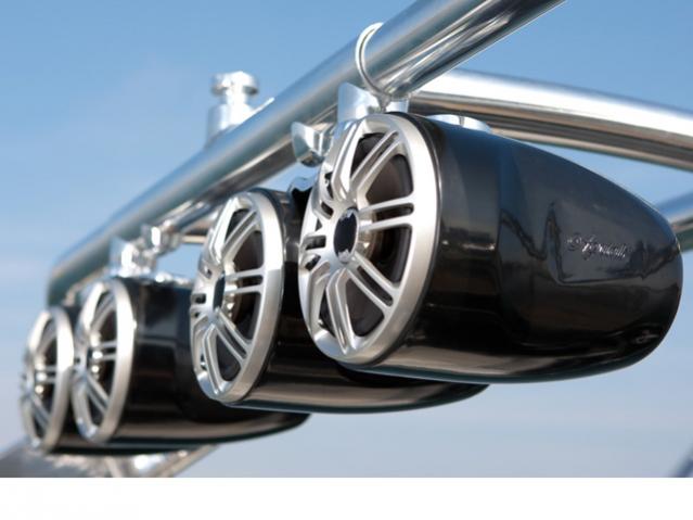

    Hey, wanted to post this for some ideas from those of you with a lot of stereo experience. I'm planning on installing my new tower this winter, and it came with a pair of twin speakers. I'd like some ideas for an amp, new receiver, and subwoofer/amp combo.
    Tower speaker specs (4 total);
    6 1/2" coaxial mid/woofer
    3/4" soft dome tweeter
    Nominal Impedance: 4 ohms
    Frequency Response 35-22kHz
    Power Handling (continuous) : 60w
    Power Handling (peak): 180w
    Efficiency: 92dB
    I'd like to amplify the tower speakers, and leave the boat speakers running off the receiver alone. I'm thinking a 12 inch sub under console with a remote level switch for the amp. And my only requirement for the deck is that it has iPod connection. If money allows I'd also like to upgrade the stock boat speakers.
    I'm on a somewhat tight budget for the stereo, not Pyle and Boss tight, but a budget nonetheless. I'm looking for something that'll sound good at the sandbar. Anyone have any input on good reputable equipment on the cheap that'd work for my setup?
