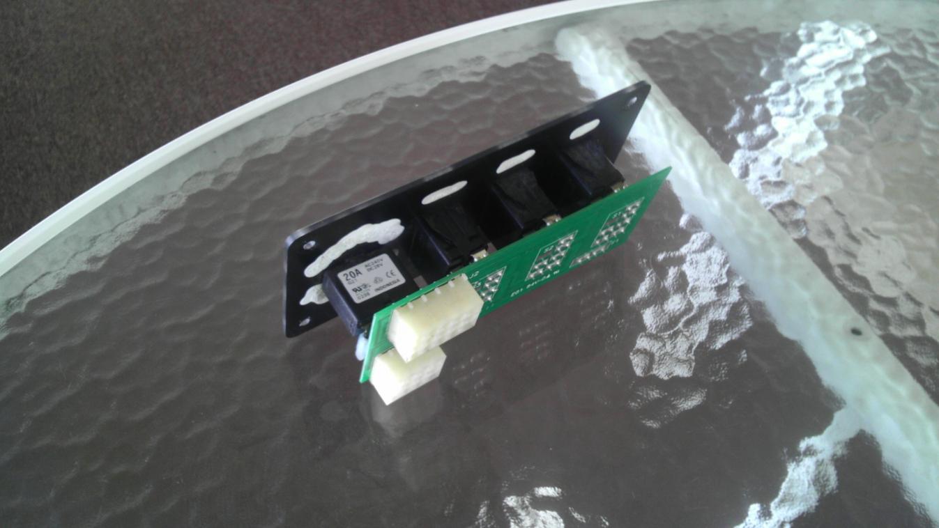

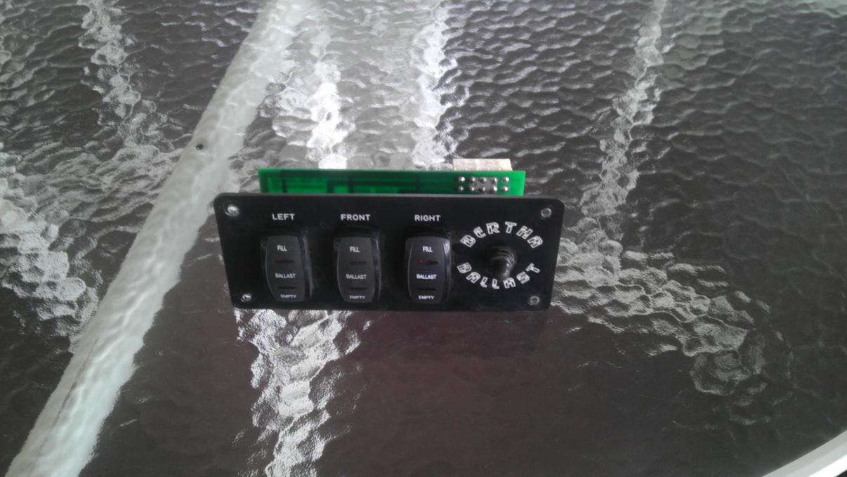

    Okay, maybe I'm missing something here, but my 03 has a Bertha ballast system by the driver seat bottom right below the throttle lever. It has the 3 rockers on it and a breaker reset switch. The light does come on, it fires the solenoid the pumps just don't actuate. I took the panel out and the 3 switches are connected together via a circuit panel (see photos) This one panel has a breaker on it, and I've tried resetting the breaker to no avail. Is everyone saying there is another set of fuses/breakers that control the ballast somewhere else other than right behind the rockers on this panel? If so I'll have to go hunting. I assumed the panel and breaker in my photos was the only fuse / breaker I was looking for. Let me know if there are more breakers or fuses or something different here.

    It would be nice to have a circuit breaker panel as easily identified as that. But our circuit breakers at least on my '03 and I suspect kcharles' as well are right on the panels. As you can see in his first pic, the logo "Bertha Ballast" has the circuit breaker right in the middle of it. And same thing for mine as well as I have one above all my rocker switches on my dash. The fuse box though is not the same either at least on mine. I can't make out any lettering or designation of what each fuse is. I have a request to my local Moomba dealer (300miles away) to get a wiring diagram of my boat. We'll see what they come up with.

    Yeah we have a breaker right on the GIII switch panel as well. I have never had to use it but I am glad its there if I need it.
