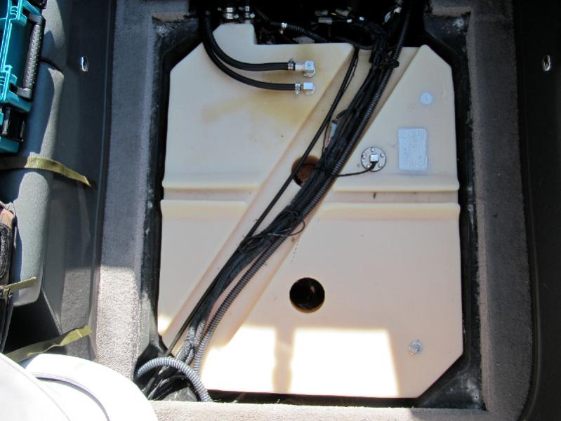

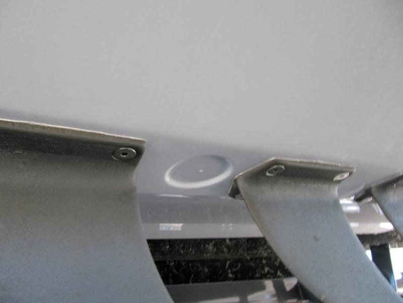

    So I have good news and bad news about adding a "T" handle drain. There is a flat spot on the bottom of the hull in the '08 lsv but it is not accesable from the top through the tank. The only thing I could figure out would be to add a drain that you accessed from the underneath the boat. There would be limited drag on the plug as it is located between the tracking fins which would help to divert water around it. The tank is raised about 1" from the bottom of the hull so you would have to be careful when drilling through not to hit your gas tank. This is probably the way I will go, while not convenient it at least allows me to drain the water when i want to without removing the floor and vacuuming it out.
    Here is a pic of the gas tank on my '08 LSV. Notice the hole towards the bow in the tank.
    The good thing is that the hole is large enough to fit a "T" handle and your hand in to drain the water as this seems to be the lowest accessible point of the hull.
    The bad news is that there is also a flat spot on the bottom of the hull, but it does not line up with the hole in the gas tank. It is smack dab in the center of the gas tank were no hole is available.
    The spot on the bottom of the hull that lines up with the hole in the gas tank is just to the front of the first tracking fin. The problem here is that this is also the place were the hulls deep "V" shape begins. Not sure if you could put it off to one side of the center line or how it would affect the structural integrity of that part of the hull.

    priceless info. how close is the second hole to being over the flat spot? could i mod the tank? i know nothing about polymer work. I hate to try to find a newer tank when mine works

    Yeah what about the hole in the center of the tank? I know that the hoses go there but could possibly put something there to keep the hoses to the side of the hole to reach the T-handle.

    Quote Originally Posted by weston579 View Post
    Not even close from what I could tell, the flat spot is in the middle of the tank between the two holes from the measurements I took... Your on your own with the tank mod, that is one bear I wouldn't poke with a stick if you paid me...
    Quote Originally Posted by walb0244 View Post
    The problem with the other hole is that from what I remember it is directly over one of the tracking fins.... I am heading back over to do some ballast work on it tomorrow so I can spend some more time than I had the other day to double check my measurements.
    I picked up a 2" brass drain from west marine earlier just to see if it will fit the flat spot under the hull. May not be convenient but at least it will be there if I need it. Anybody have any other ideas before I start drilling?

    After speaking to skiers choice about a newer tank install that wouldn't work due to the fuel pump being inside the tank, decided to put a hole in the flat spot between the front 2 track fins. Im going to just remove the plug from the bottom and cut the head off the T handle to make a recessed access. The plugs are brass, so its easy to do whatever you want with it.
