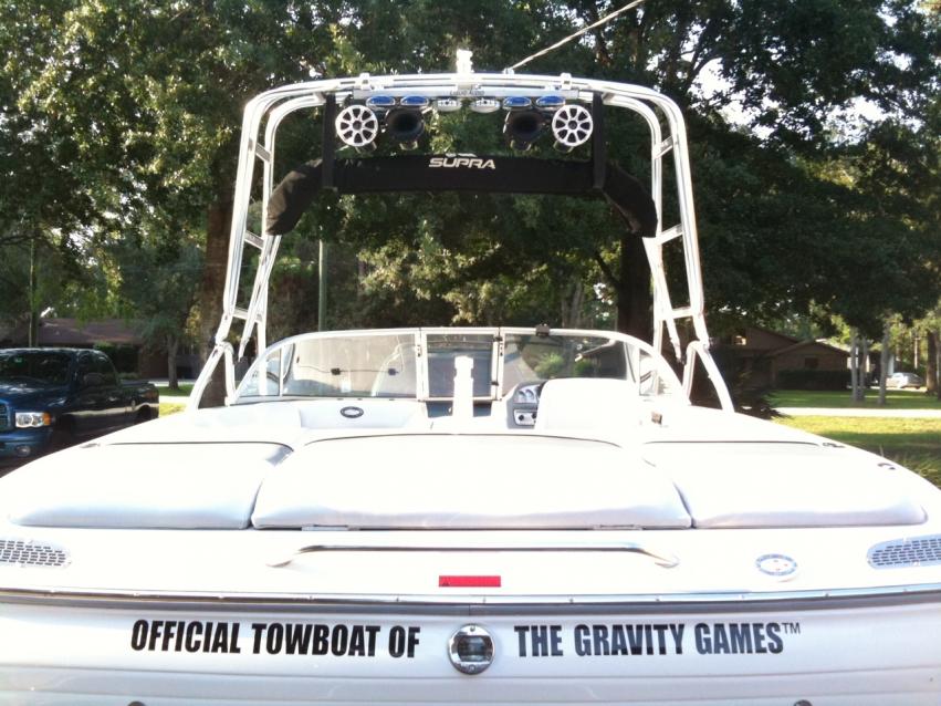

    I had the infinity tower speakers and they were ok for the money. Nothing compared to the wet sounds or exiles. I won a set of the LA double cans with the kicker hlcd on ebay from LA for 440.00. They sound better then the infinity's that were on before and these are underpowered at the moment. I only have 125w going to each can. I am going to upgrade the amp this winter. They are definitely louder and cleaner sounding then what I had before and also reasonably priced.
