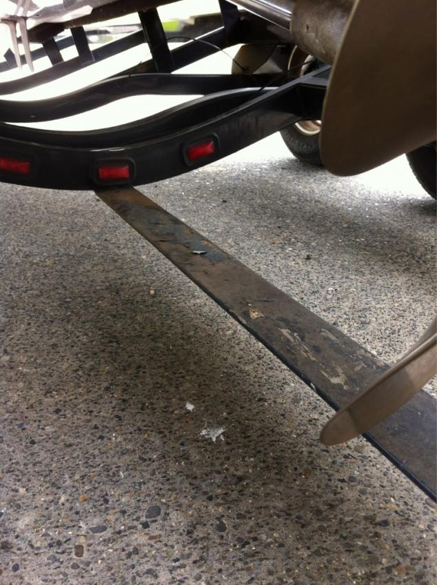

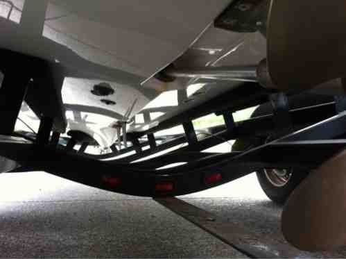

    Mine is t'd into the exhaust manifold quick disconnect line. I'll probably move it one day to a cooler water source.
    I have noticed that the hot water drains out on to the prop crossbar on the trailer and has removed the paint when it drains down through he seal due to the very hot temps.
    how often do you run the boat on the trailer?
  2. #12
    Jul 2011
    Murrieta, CA
    1,268
    The hot exhaust water drains out when we put the boat on the trailer from a day on the river. I don't run on the fake a lake very often.
    ImageUploadedByTapatalk1338145172.433310.jpgImageUploadedByTapatalk1338145201.425577.jpg
