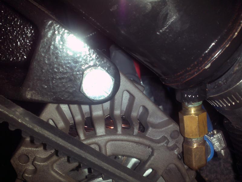

    On my '10 LSV it is coming from the drain plug of the transmission cooler.

    Here is a pic of the setup at the cooler. I dont know if the drain is after the cooler screen or not. I would hope so, but I have also inlet strainer before the vdrive.
    That's awesome. I see yours is tight to the alternator. Not sure if I even have that much clearance on my 09. Thanks for the pic. I have a strainer as well so I see no reason I couldn't flip the cooler and have the drain at the top
    BTW there is no screen in the tranny cooler it is honeycomb thru out so it does not matter which way it faces. Talked to indmar on this. Thanks again
