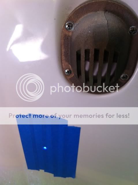

    For the rear fill pumps I went with a 1" intake to a ball valve to a T fitting, then 1" hose barbs to a very short hunk of hose and right into the Attwood 3902 fittings on the bottom of the Tsunami Pumps. I did a lot of research on this part and as many already know there are no adapters from the T-1200 down to a 1" thread. There is to 3/4" but I didn't want to lose any flow.
    Going this route also gave me some flexibility in pushing the pumps around and making them fit but still have a little bit of give.
    An important lesson learned here was dealing with the tapered threads on the thru hull intake. I was worried about my pumps sitting too high off the floor and not priming so I decided to take about an inch off the thru hull fitting. The trick is they are a tapered thread so I had to put a taper back on the thru hull in order to get the ball valve to screw onto it. Luckily my neighbor is a plumber and had a mongo pipe thread set and a few beers later we had it! This was a huge delay in progress trying to fix the threads though.
    After measuring about 10 times I had roughly a half inch to spare to get my pumps where I wanted them in the cramped bilge space and still be able to move the shutoff handle if I ever needed to.
    Time to cut a hole!
    5,017
    I drilled a pilot hole from the top down just to make sure I was in the right spot. It turned out to be almost symmetrical with my existing intake for the old Rule 1100 which was nice. I taped over the pilot hole and busted out the hole saw. This is the part where it takes some liquid courage (aka more beer) before you pull the trigger...
    But not bad after you're done. I used a fair amount of the marine adhesive on the thru hull going in to ensure a good seal.
