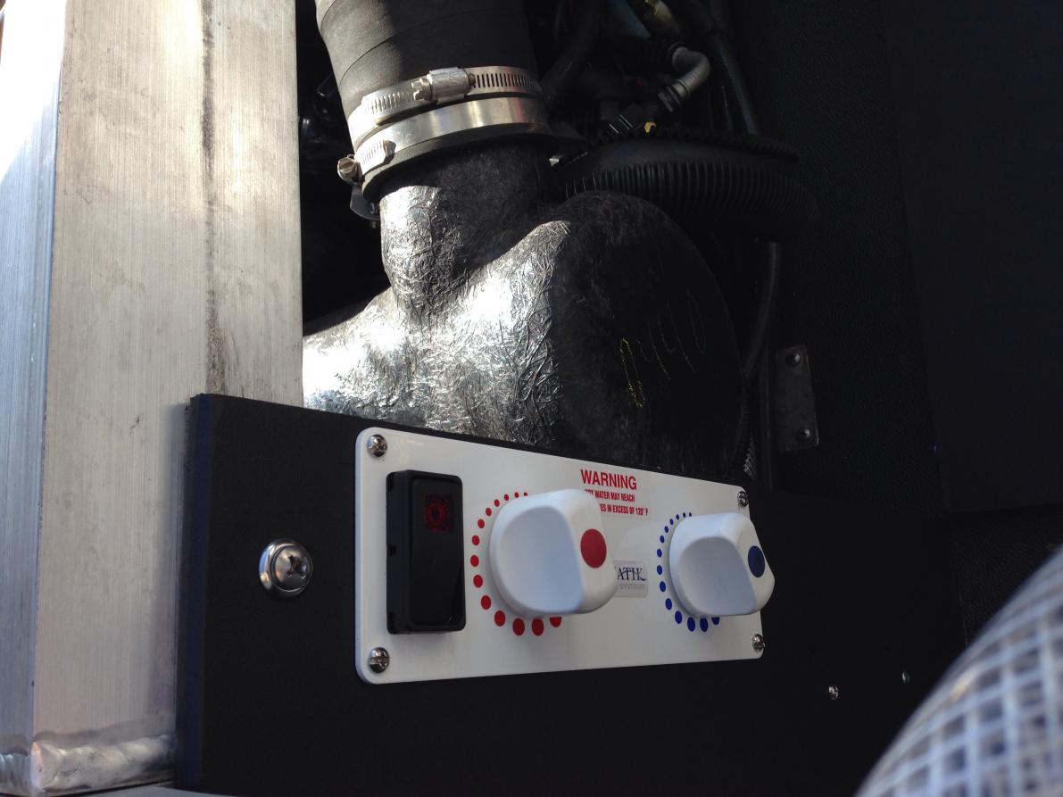

    Got the pump from RV Upgrades it's a REMCO pump. Here is the link.
    http://www.rvupgradestore.com/Power-...66-1e1-80a.htm
    I ordered the valve/switch from Heatercraft:
    http://www.heatercraft.com/flush-mou...e-with-switch/
    Then Lowe's for all the brass and nylon fittings, hose clamps, hose, wiring, and shower head (used a fireman's style garden hose head for $3.50)
    The only issue I encountered yesterday at the lake was it kept popping the 10 Amp fuse when I left it armed. The pump is an on demand so it tends to "bump" when it's armed but not running. I upped the fuse to 15 amp and havn't had any more issues after a whole day on the water. The heatercraft website said to run the 10 amp, but the pump instructions said to run 15 so I'm not too concerned about overloading the wiring based on that. I ran 12 and 14 ga. wire for the whole system. Ran the pump ground and positive wires straight to the orange and black alternator leads which keeps the pump turned off when the boat is off.
    Water was 58 yesterday and the novelty of having hot water in the suit before I got to surfing was awesome. I'm also really pleased with the pressure from the pump. It's more than enough to shoot some water to neighboring boats this summer or fill balloons or whatever.

    Beejwest, where exactly did you tap in for the hot water lead off the engine. The pic you have shows the brass fittings and shutoff valve but I can't make out where on the engine it is... Port/starboard, was there just an existing plug? Also, could you use galvanized pipe fittings instead of brass?

    I tapped the block plug on the starboard side of the engine, so it's closer to the pump. It's a brass plug about 1/3 of the way from the front to the back below the spark plugs, right on the block. There are pics of it in the winterization sticky on this forum. I use a shop vac when I pull the plug to suck water out of the block so it doesn't pour into the bilge. Then take that plug into a plumbing store and match the threads. I don't know why you couldn't use galvanized, but I'm not for sure. Maybe someone else can comment on that? I used brass because it's soft and I knew it wouldn't screw up the threads in the block if I cross threaded/over tightened. Plus that's what Newty used. I was copying lol.

    https://forum.moomba.com/showthread....ith-pics-by-Al
    Here is the link with pics from Al. He has some pretty good shots of the plug hole, with wrench sizes.
