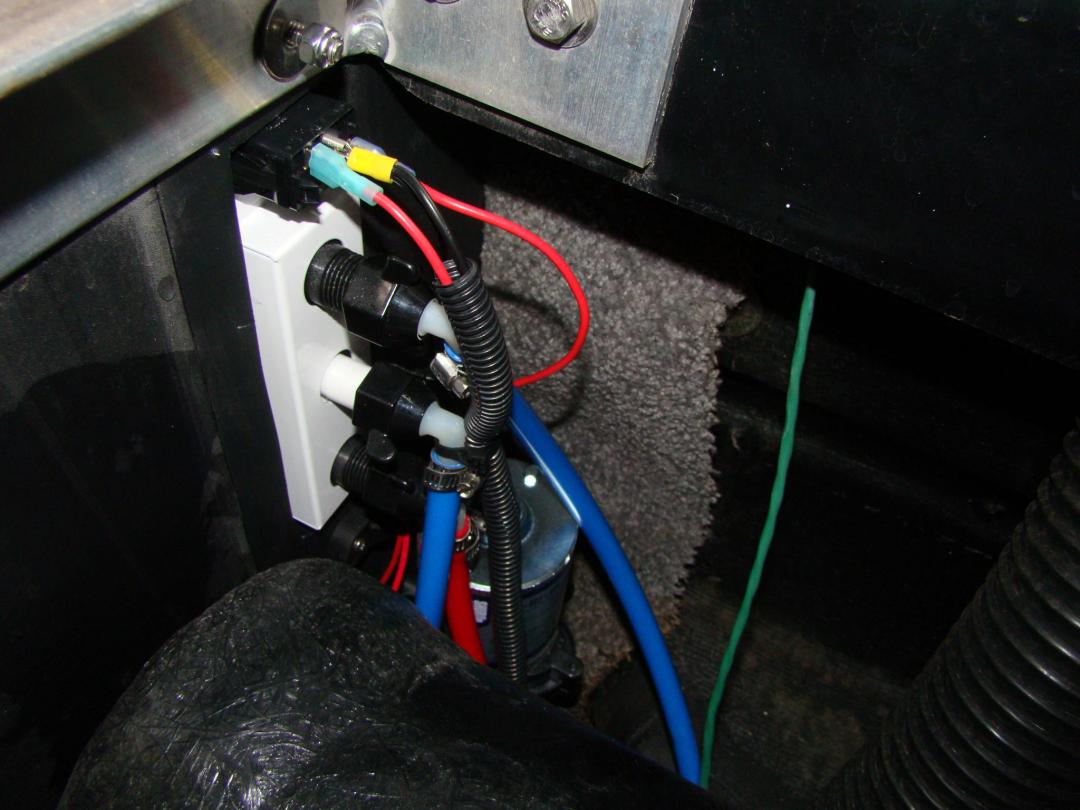

    Next thing I did was wire the pump to the switch.
    Plumb the pump suction to the mixed hot cold outlet.
    Add the shower hose to the discharge of the pump.

    Install the panel and make the connections. I have red and blue 3/8 air hose so keeping the hot and cold seperated was easy.
    I then fused the switch and got a 12v tie in at the alternator.
    If you guys decide to do one on your boat you'll love it. I'll never have a boat w/o one.
    Super easy install with the exception of finding all the parts. Took me about and hour and a half start to finish.
