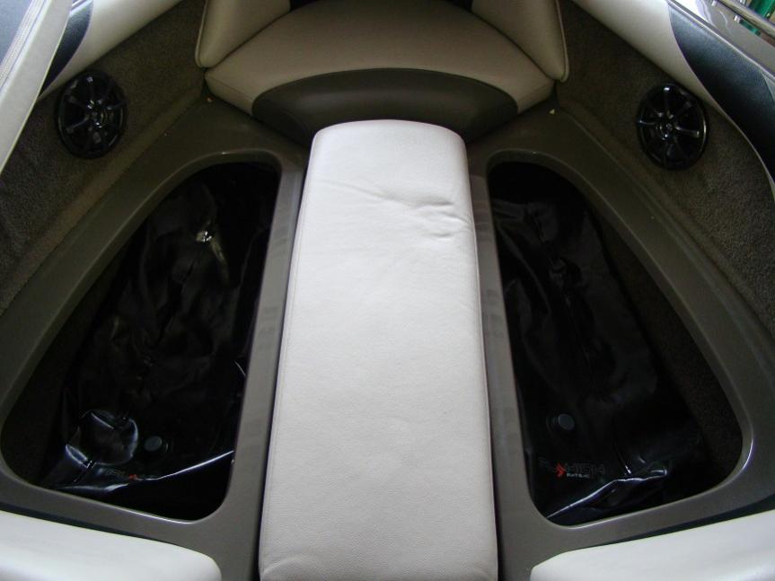

    First mark and drill your holes, 1 1/4" in the floor and 3/4" in the hull.
    One thing I noticed is that depending on the day the boat was built the two ballast thru-hulls in the back are going to be spaced differently. So measure the distance between the two back ones and drill your new one the same spacing from the old front to match the spacing on the rear. Make sense?
    Now I drilled the hole in the floor behind the stainless angle under the passenger bow seat to keep things tight. If you don't want to drill a hole and you have room in your boat where the battery cables and such come through the floor just run the hose there.
    Slide the bow bag back a little to access the front port. For some reason my floor sac fittings were not glued like the rear sacs were from the factory so it spun right out. Results may vary. Depending on the orientation of the bag make sure the port is on top, meaning it would make it a vent.
    Attatch the hose to the quick connect and install it on the bag.

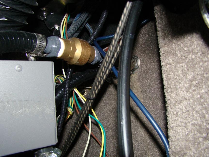

    Here is the tricky part. Install the two male threaded by barbed to the spring check. You need to remove the floor sac hose from the through hull and install the spring check with the arrow going out of the boat. Now you will need a short hose to make the connection from the spring check to the hull again. This does two things:
    1. It keeps air from filling the floor sack on the road.
    2. It it creates just enough back pressure to divert the pressure from the full floor sack to the IBS in the bow.
    If you want to fill just the floor sac you will need to keep a close eye on it as not to overflow into the IBS.
    When both sacs are full the water will overflow out of the new through hull.
    The empty pump of the floor sac can easily overcome the spring check so no worries there.
