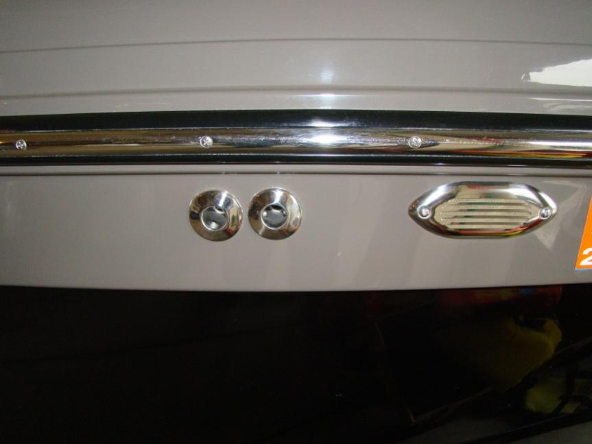

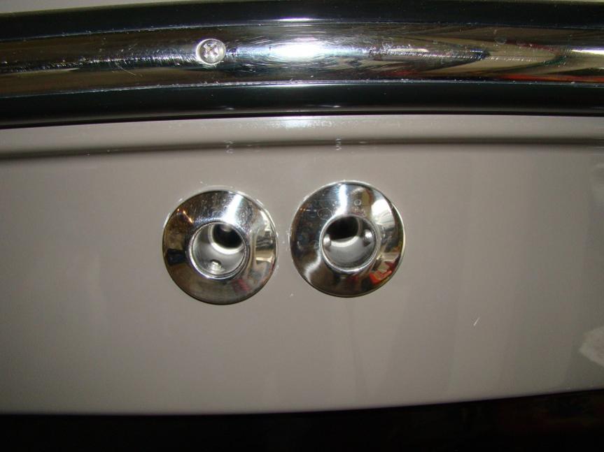

    First mark and drill your holes, 1 1/4" in the floor and 3/4" in the hull.
    One thing I noticed is that depending on the day the boat was built the two ballast thru-hulls in the back are going to be spaced differently. So measure the distance between the two back ones and drill your new one the same spacing from the old front to match the spacing on the rear. Make sense?
