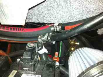

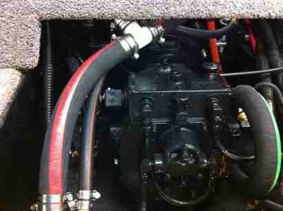

    The filler neck I got my dealer to order for $60. The hose's and tee's from a local hydraulic supplier. ImageUploadedByTapatalk1370407455.624214.jpgImageUploadedByTapatalk1370407479.766082.jpgInstall was easy. Drill practice holes so you get the spacing right. And have a file on hand for the finishing touches. A little bit of weatherproofing foam to fill the void and your done.
    Hopefully I get to try it out this weekend. Weather has been shitty up here.
    I know already that the factory side is going to be a slow fill but it will be worth it, for me, anyways.

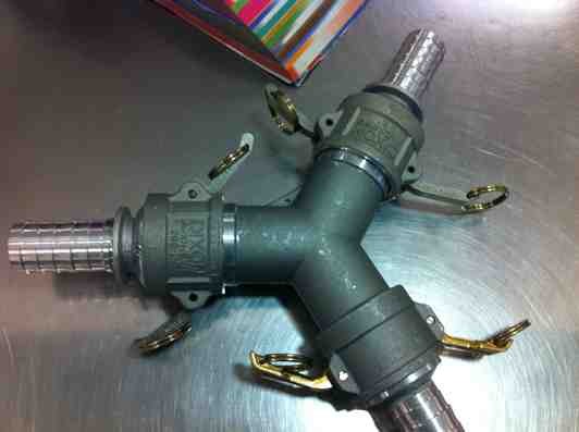

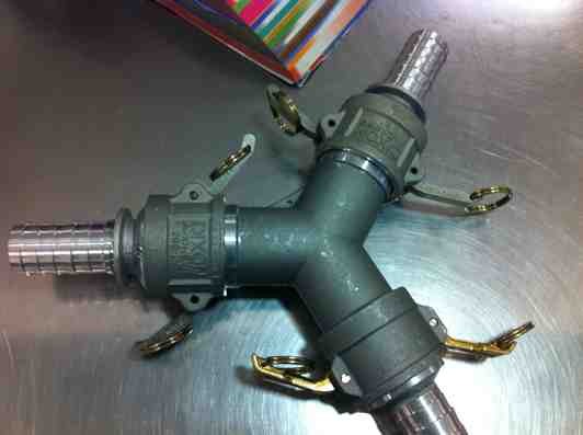

    are you thinking this is due to the Tee fitting ?
    props for being the first, you sure made it look simple. I allways wondered about that ridge and how to overcome that.
    Yes it will fill slow because of the tee. I just can't find a 1-1/2" wye fitting anywhere. This was as close as I could get...ImageUploadedByTapatalk1370476139.164838.jpg and I wasn't going to go there!
    I'll snap some side views this weekend for you. The ridge was fine to go over.
