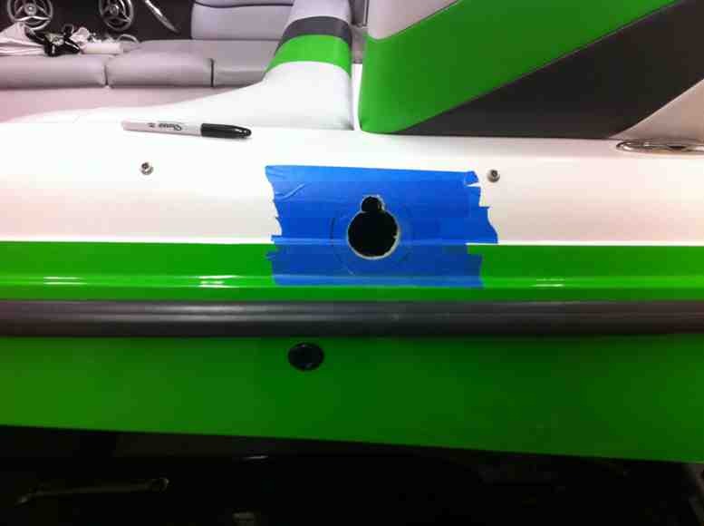

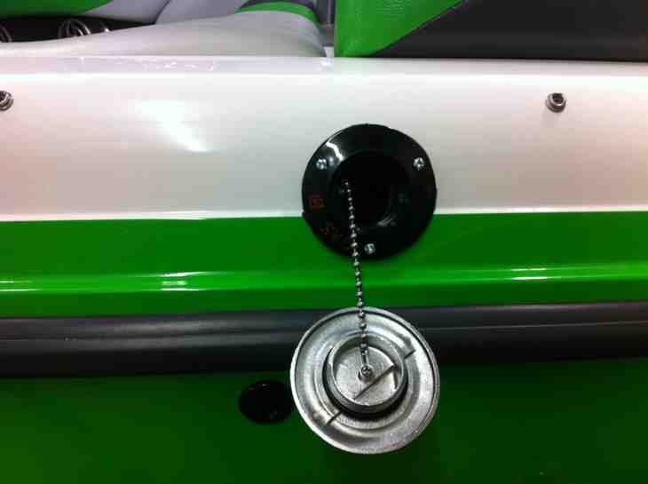

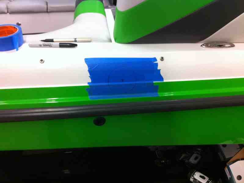

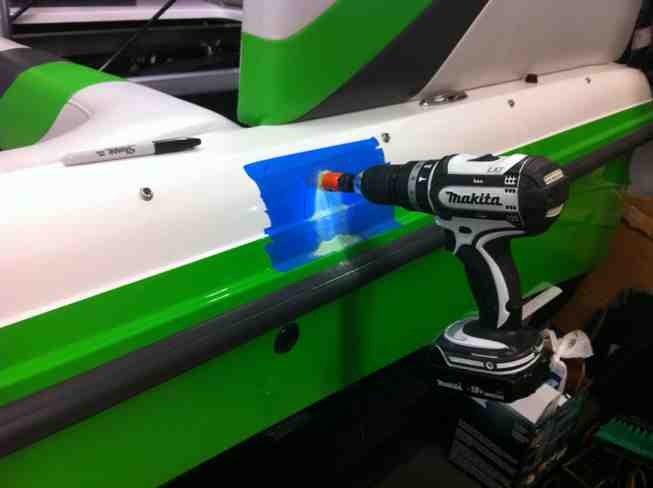

  10. #50
    Feb 2012
    St. Albert, Alberta, Canada
    170
    Default Gas Filler on Left Side
    Quote Originally Posted by brain_rinse View Post
    You did it! Ok, some details for the copy cats?
    Practice drilling on a piece of wood first!!!!!
    Then practice again!
    Getting the vent part through takes a little filing.
    Only drilled the holes and mounted the neck last night. Doubled up some foam weatherstripping and it formed to the ridges on the side nicely. Looks like it belongs.
    I'll plumb it this weekend, hopefully.
