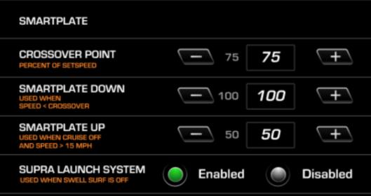

You can adjust the “launch” system set points. Specifically your crossover speed where your plates transition from launch mode to surf mode.
But too much stern weight and not enough bow weight is your obstacle.
It's my understanding that the tabs are not used for launch in surf mode?
if you look here in the settings it says launch is only used when swell surf is off.
I think these settings only effect the center plate.
https://forum.moomba.com/attachment....8&d=1599658797
https://forum.moomba.com/attachment....9&d=1599659014
