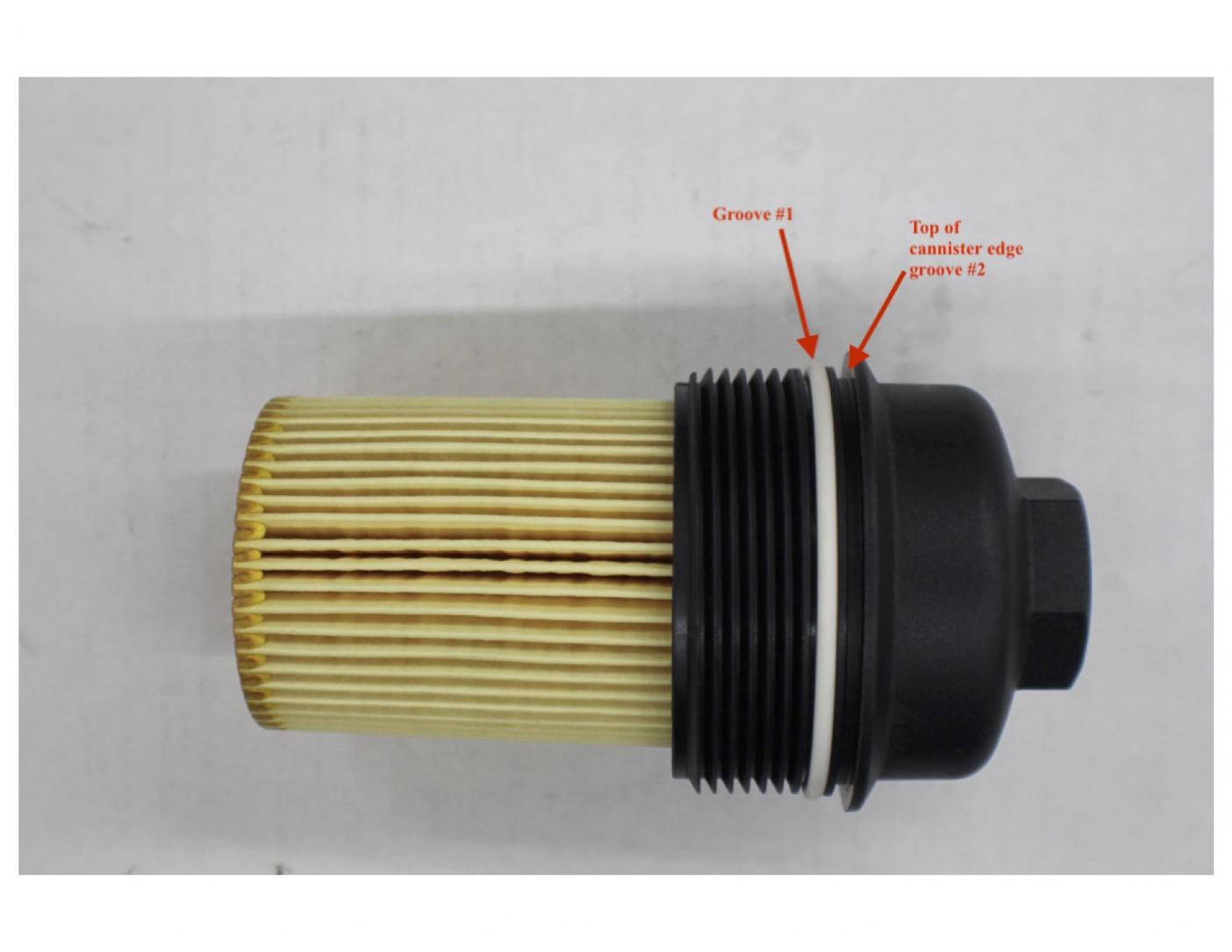

The o ring groove in the photo is correct and it's a pita to get it out of that groove.
It's reusable a few times and not all filters come with a new one.

For clarity, this is what I am talking about, see photo. There is a groove at the very top edge/rim of the canister, I labeled it groove #2, then one just below that area, I labeled it groove #1. The photo has a white rubber o-ring in groove #1, that I am reading from everyone is in the correct placement location of the o-ring. Groove #2 is incorrect and not where the o-ring goes. correct? Attachment 30849

Ok thought so too after looking at the filter housing. (thanks for that edit! ;-) I was questioning myself deeply) If I recall, when I initially removed the cap, on the first oil change, the o-ring was in groove #2, at the very top of the housing.
