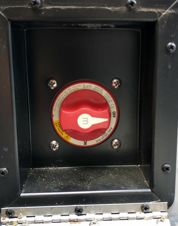

Here is the switch, fits in the factory spot.
Attachment 30936

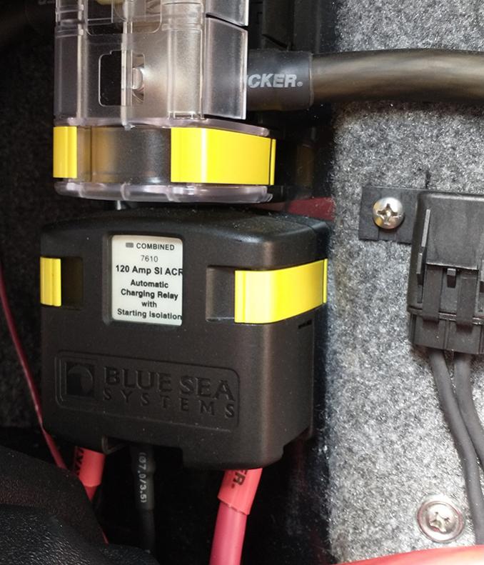

The ACR.
Attachment 30937

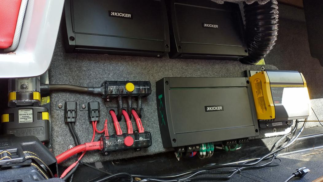

Didn't quite fit on my amp board, but my charger did.
Attachment 30938
