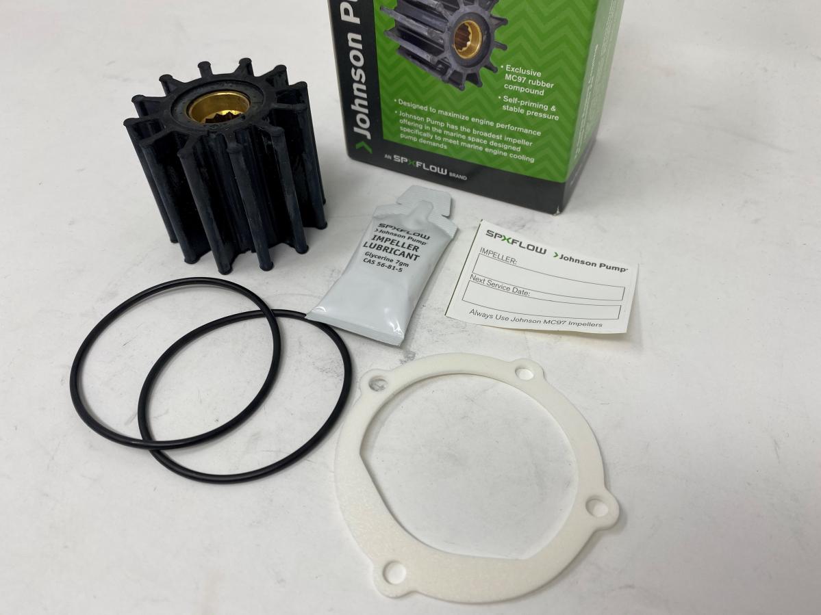

This is the impeller kit.
REPLACEMENTKITS.COM - Water Pump Impeller Kit Replaces 09-812B-1 Johnson F6B-9 102480501 - https://www.amazon.com/dp/B073PGLJRK...ing=UTF8&psc=1
Not sure on how easy the pump cover access is in the max, it is very easy on Supra’s through the surf locker engine cover.
https://uploads.tapatalk-cdn.com/202...85926bd3ff.jpg
4 bolts, needle nose pliers to wiggle the old one off the shaft, use grease supplied or WD40 to install and use new gasket.
