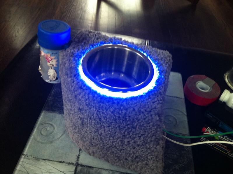

We had a rainy weekend, so I decided to put some scrap acrylic and spare LEDs to good use and try to make my own LED cup holder rings. I must say, they turned out pretty sweet, and I like the lower profile as opposed to the commercially available units, which are a bit thicker.

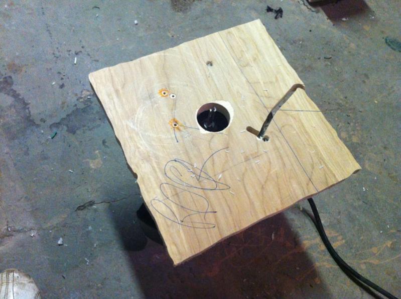

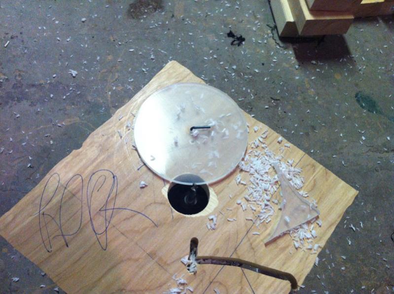

Keeping in the 'low budget' feel of this project, rather than buying a router table, I made one of my own, lol. My router has a 'plunge' option that made this work awesome, basically I was able to have the bit under the base of the table, put the acrylic in place, then push the table down onto the spinning bit, cutting into the acrylic. The key in the cutting is constant motion to keep from melting the plastic;
https://forum.moomba.com/attachment....2&d=1334592915

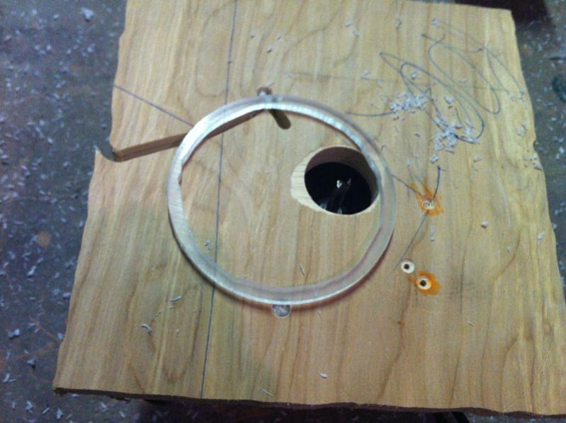

I measured out radius for the inside and outside of the circles and drilled a hole in the "table" for each, and marked them with an orange highlighter so I remembered which were correct (it was a trail and error process).
So, to start I drilled a hole in what will become the center of the circle. From there, I used an allen wrench through the hole and into the hole on the table that I drilled for the outside, cutting a perfect circle;
https://forum.moomba.com/attachment....3&d=1334592930
Then I switched the allen wrench to the smaller hole and cut the inside circle;

Note - the inside circle was a little tight so I had to open it up freehand with the router, hence the rough inside edge - not a big deal since you can't see once mounted.

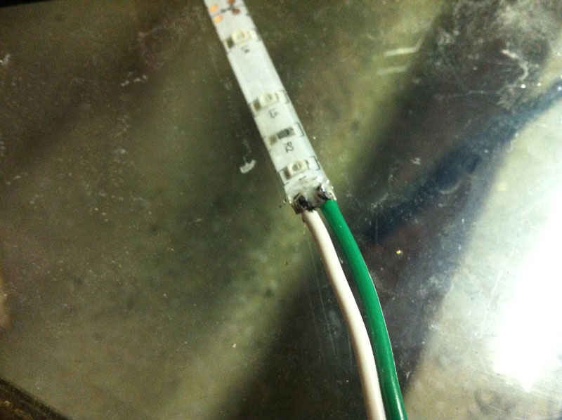

Once I had the rings figured out I needed to shorten the LED strips - easy enough, I just had to cut them to length and solder wires onto the ends;
https://forum.moomba.com/attachment....5&d=1334592970

Ready to mount. the ring and LED strip;
