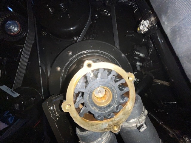

Are you talking about how it looks smashed at the top of your pic?
This is the impeller sitting inside the pump. Notice the clearance differences.
https://uploads.tapatalk-cdn.com/202...4850791f24.jpg
That looks normal. Pump housing isn't a perfect circle. And they do tend to stay bent from use. If you let it sit out in a warm place long enough it will probably straighten back out.

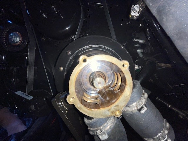

here are pics i took from my first time changing mine.
Attachment 30783Attachment 30784
