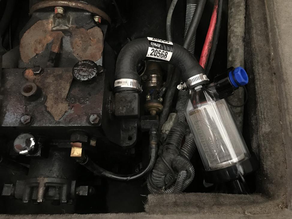

I installed the new sea strainer last year and it is absolutely worth the $100. Very easy to run off the hose now.
I did have to cut off part of my intake hose to make it fit but that was fairly easy to do with a hacksaw.

Looking for directions on what this would take to install on CAT 340, the indmar one with the hose attachment. Thanks
Is this the one?

Yup that's the one. It was a breeze flushing and adding antifreeze this year. I had to empty the strainer once and it was no problem at all. It wasn't the mess I thought it would be. Glad I did this upgrade for sure. Peace of mind having a ball valve on there now also.
I hate to bring up an old thread but I’m looking to add the sea strainer also. Given the boat is in storage, is anyone able to confirm that the water hose is 1 1/4”?
2018 Mondo
Not sure which hose you are referring to but the sea strainer was basically plug and play on my 16 Mojo. Just cut the hose between the through hull valve and the v-drive inlet and install the strainer. Might have to remove a few inches of hose. The size on the strainer is matched the hoses used from factory on the indmar raptors. The threaded garden hose inlet is standard as well to all "normal" water hoses.
Yes the hose connecting to the v drive inlet. But they make the strainer in 1” and 1 1/4” size. I believe that inlet is 1 1/4” hose. Are you able to confirm?
Yes, in the boat for some garage boating right now. It’s 1.25”. Good luck!
Perfect. Thank you!
