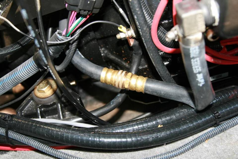

Just did my 2014 Mojo yesterday with a 330 assault. The Indmar manual had this pic for the hose that connects the manifolds, but I can't find it on mine. There were two hoses coming off the front of each manifold that went to a T-valve that had a 3rd drain hose, near V drive. This was all I could find coming off the manifolds. Am I missing something? Just got the boat this summer, so first time doing winterization, don't wont to miss something.

The hose that comes off the T goes to the dripless seal. At least it did on my 09. Its not a good setup as hot water is going to the dripless shaft seal ( causing dripless housing expansion and dripless to become a drippy shaft seal.) This in turn makes the exhaust self draining iirc. I cut mine put a ball valve on it for draining and re routed the dripless cooling off the tranny cooler for cold water.

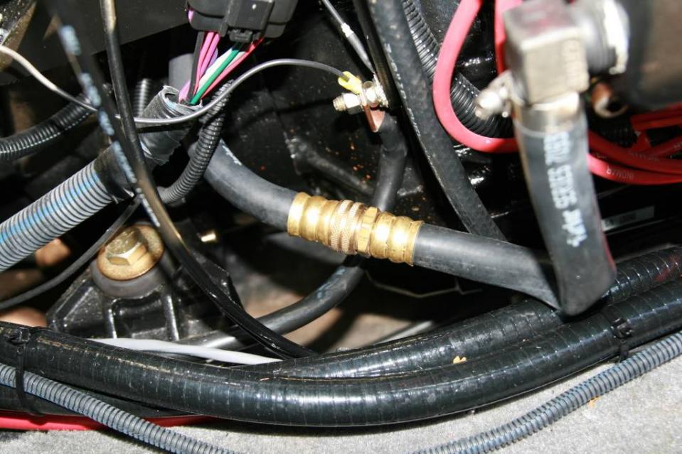

i have a 2003 supra santera and am trying to figure out how to get to the starboard side block plug. its not open like the port side as there is a walk way. Anyone have any insite on how they did it?
Does it look like this?
Attachment 27804
That does look like a PITA.
