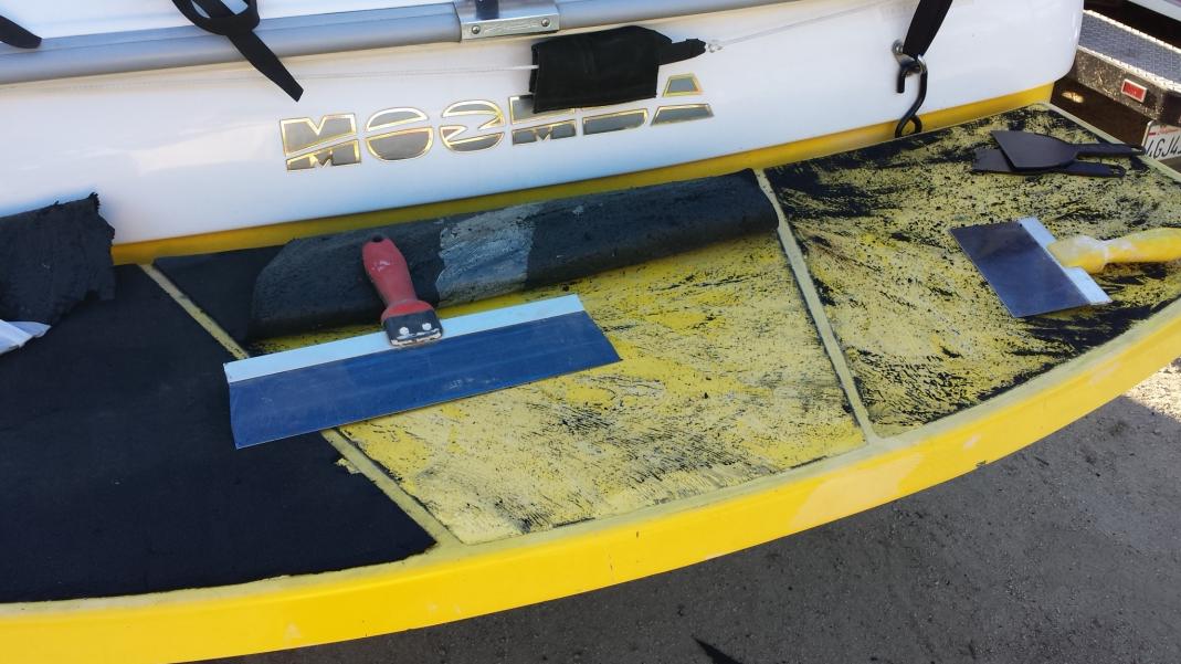

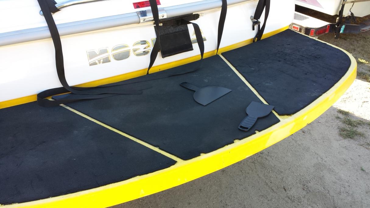

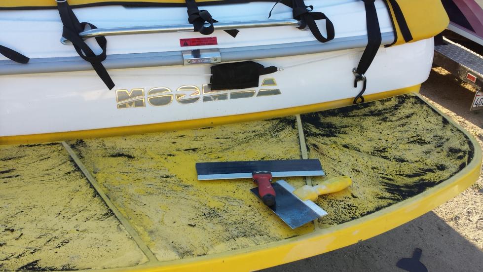

- Putty knife
- Mineral Spirits
- Acetone
- Gasoline as a last resort (Of course NOT...well...)
- All in a ventilated area (i.e. outside)

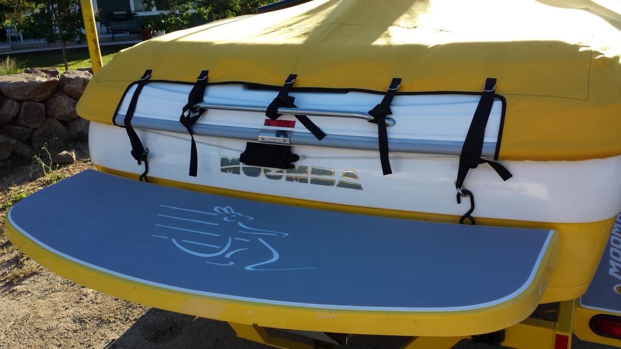

- Call SeaDek
Attachment 17857Attachment 17858
Attachment 17859Attachment 17860
Got that out of order. 1. Call Seadek. Wait about 5 weeks. But it takes 4 weeks to scrape that crap off anyway.
You aint kidding about waiting twelve years to let that old glue harden! I waited until we had the two hottest days of the year so far (105 in NorCal) and wasn't sure if the stinging was the sweat in my eyes or the gas fumes (Which I did NOT use and do NOT recommend!)
But I get more compliments on that stupid pad!!
