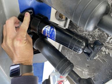

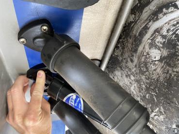

Hi there one of my actuators on the port side has frozen up I bought two new actuators that Moombah said is appropriate for my Mobius 2006. Unfortunately when I place him next to the old actuators they seem to be angled down to the ground more so than the old ones making the plate not angle right (see pics). Has anyone had issues with replacing their actuators? Do I need to soften the top part of the actuators to bend it up a bit to make the appropriate angle to make it fit?Attachment 30344Attachment 30345Attachment 30344Attachment 30345
The parts guy got back to me
He checked with Skier’s choice and they ensure that that is the correct Ram for my 06 mobius. He stated over the 16 year the plastic could have flexed to the position that it is in now. I just wish there was a picture I can compare what the tabs should look like all the way up and all the way down. If anybody has pics of a new wake plate ram set up please shoot it my way. Thx
