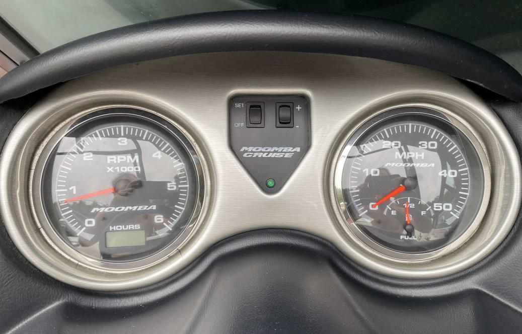

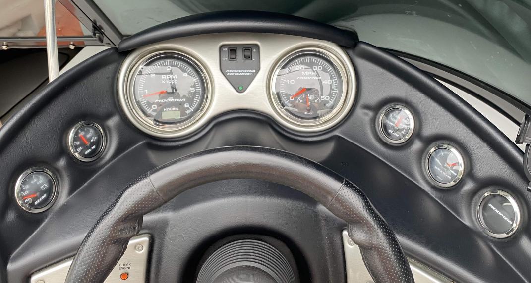

ZO Head Unit Location: I need to remove either my Tach or Speedo to make space for the 5" ZO Display. I'm leaning towards installing ZO in the Speedo location but there is a bit of a complication as the Fuel Gauge is integrated into the Speedo.

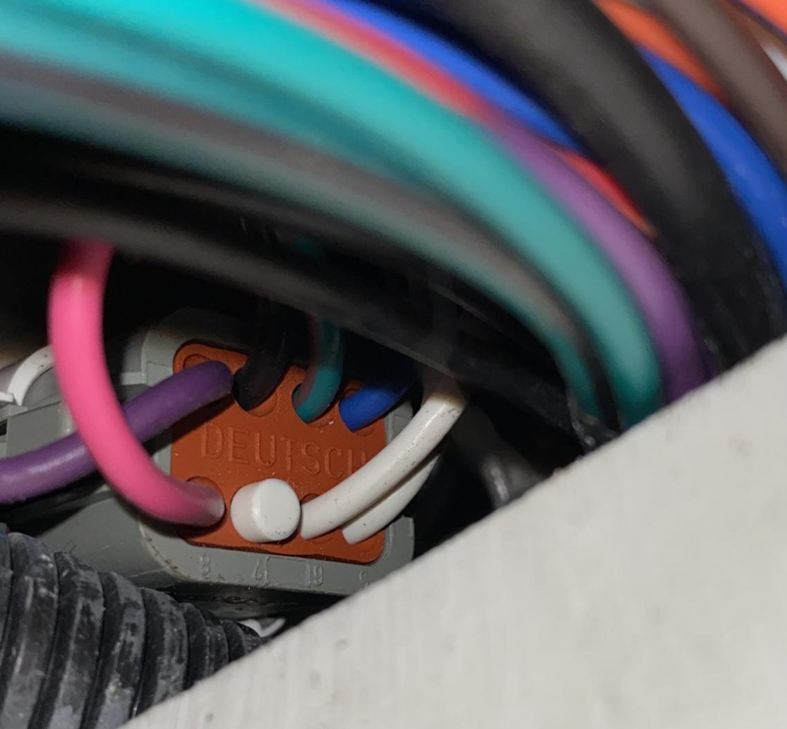

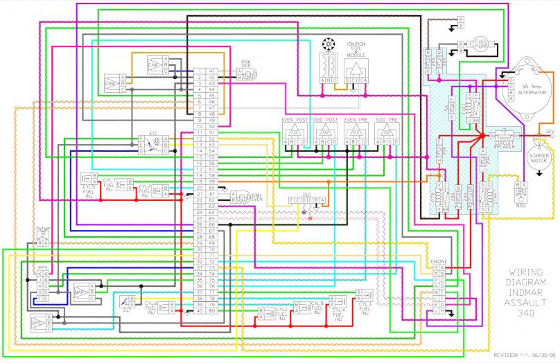

New Fuel Gauge: I have an empty 2" gauge location on my dash, I want to install a Fuel gauge in the blank location. The factory Speedo is connected with a 8 PIN connector (7 wires), I'm not sure which wires I need to splice into to hookup a new fuel gauge. I've been searching the forum and the web and have not been able to find any under dash wiring diagrams to assist here.
