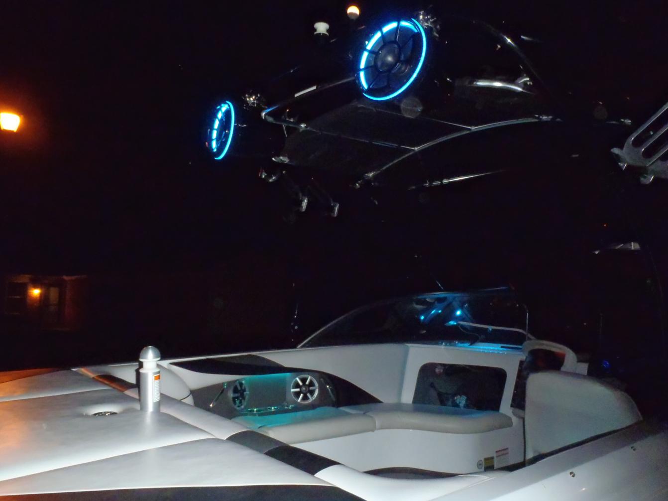

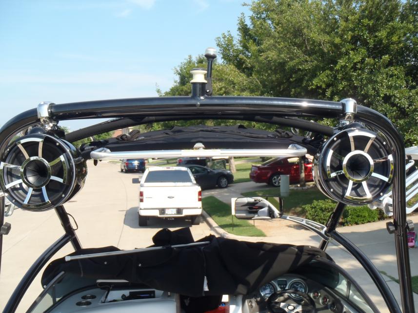

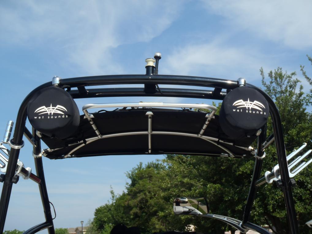

Finally took some pics of my system that I think i'm done with for now.
Attachment 14823

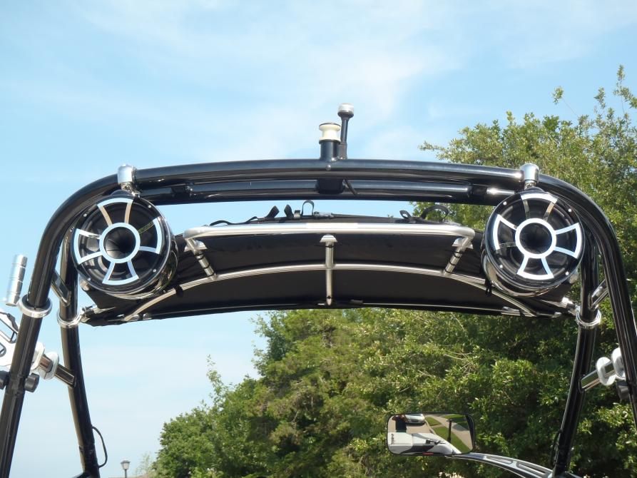

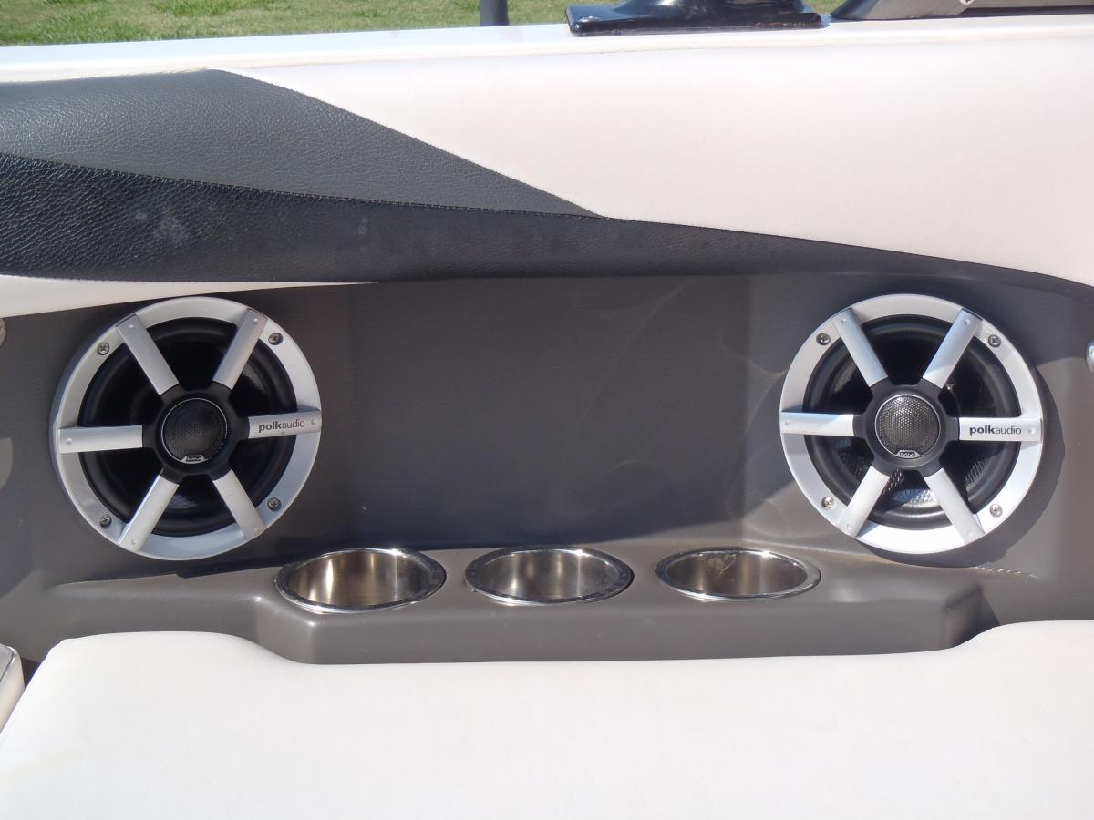

I'm currently rockin' 6 Polks MM6501UM in the cabin powered by a Kicker IX500.4
Attachment 14822

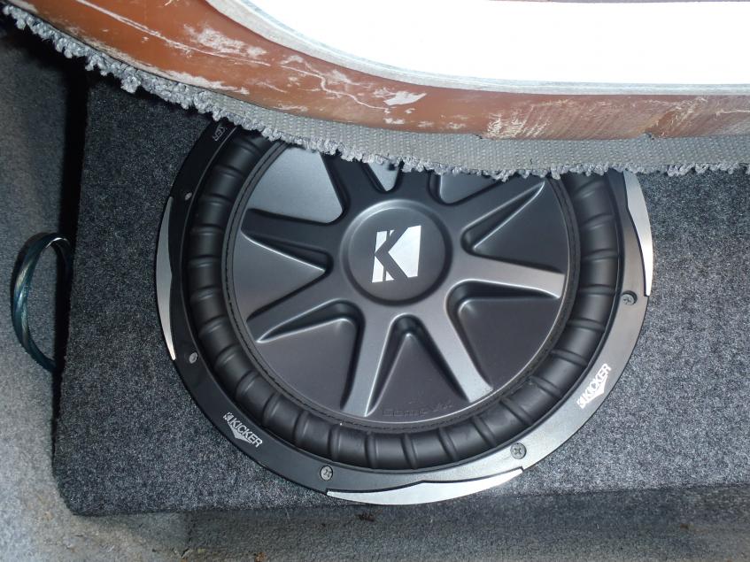

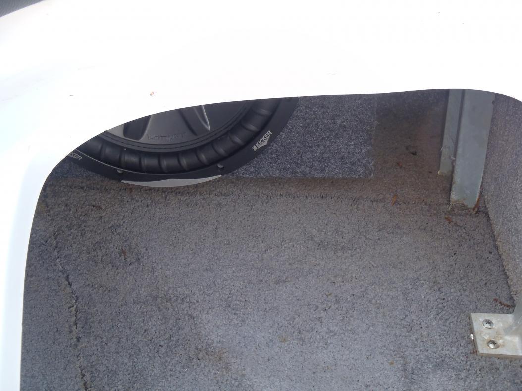

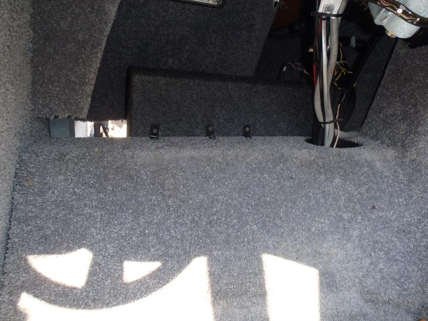

For the sub I went with a Kicker CompVX 12 powered by a Kicker IX1000.1. DFW Stereo in Grapevine, TX built and fiberglassed the box. I'm 6'3" and I didn't want alot of leg room taken up by a sub box. The installer at DFW Stereo said he could squeeze a box in front of the LSV driver footwell hump. I was a little dubious that he coulld get it to fit and that it would sound good. The box is a little over 1 cubic foot and that CompVX hits hard in that little box.
Attachment 14824Attachment 14825Attachment 14826

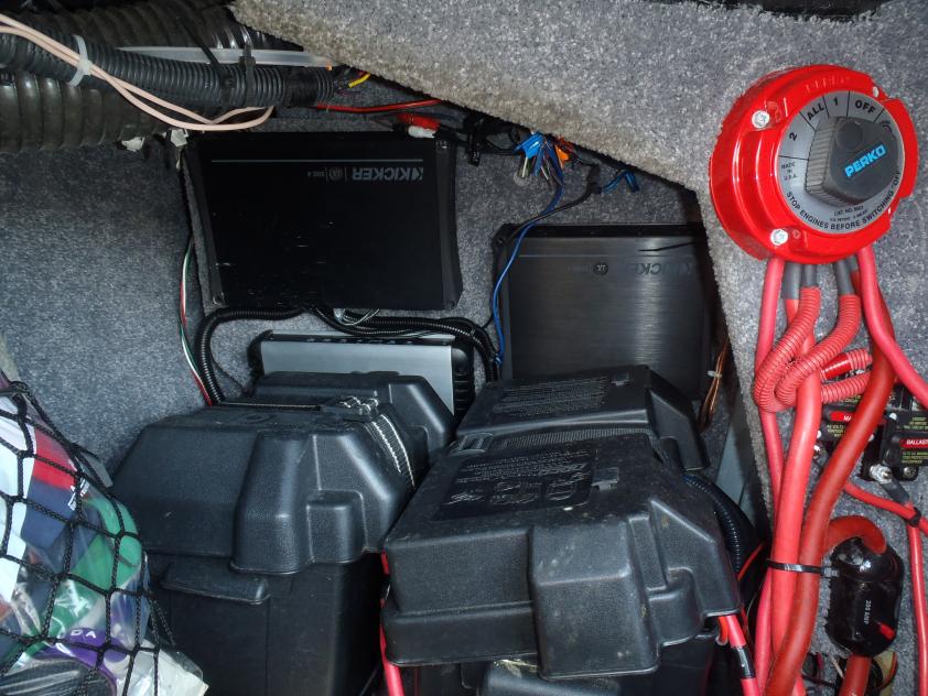

Here is the battery and amp location.
Attachment 14832
