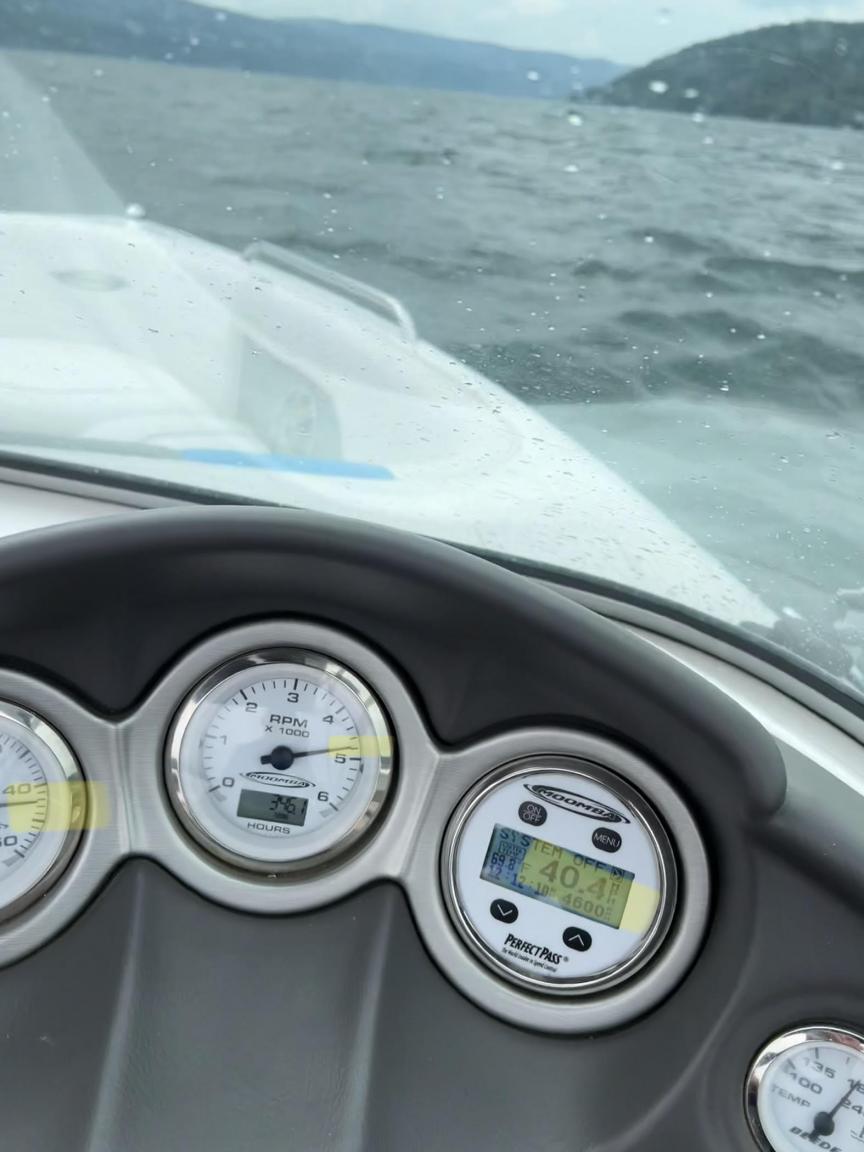

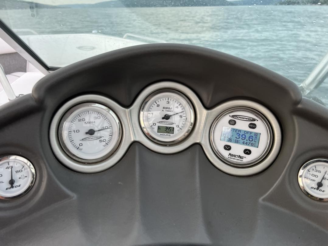

prop is a 13.7x17.5 mvc hc oj prop which i understand is stock diameter and pitch so iiuc the low rpm is not a prop pitch issue and ‘correcting’ the low wot rpm issue by lowering prop would mask a potentially real and serious issue.
Top speed is about ~39 and top rpm is ~4510-4560 (alone or loaded).
spec for my engine is 4600-5200.
per engine manual wot should be on higher end, and others with same boat say they get top end rpm and closer to 45mph.
My concern is not with the speed or performance.
My question is if it’s symptomatic of a real issue, then i do want to track it down. it sounds serious per manual and others to be below minimum and so far from upper range of wot. my concern is the underlying cause - if the engine isn’t performing as it should due to other issues and consequently could cause (long term and or catastrophic) damage.
my speed matches gps (pp stargazer) so it’s not off by 5 mph. i also have tach and pp rpm so i think it takes gauge error out of the mix bc they both get the same signal and give me same rpm.

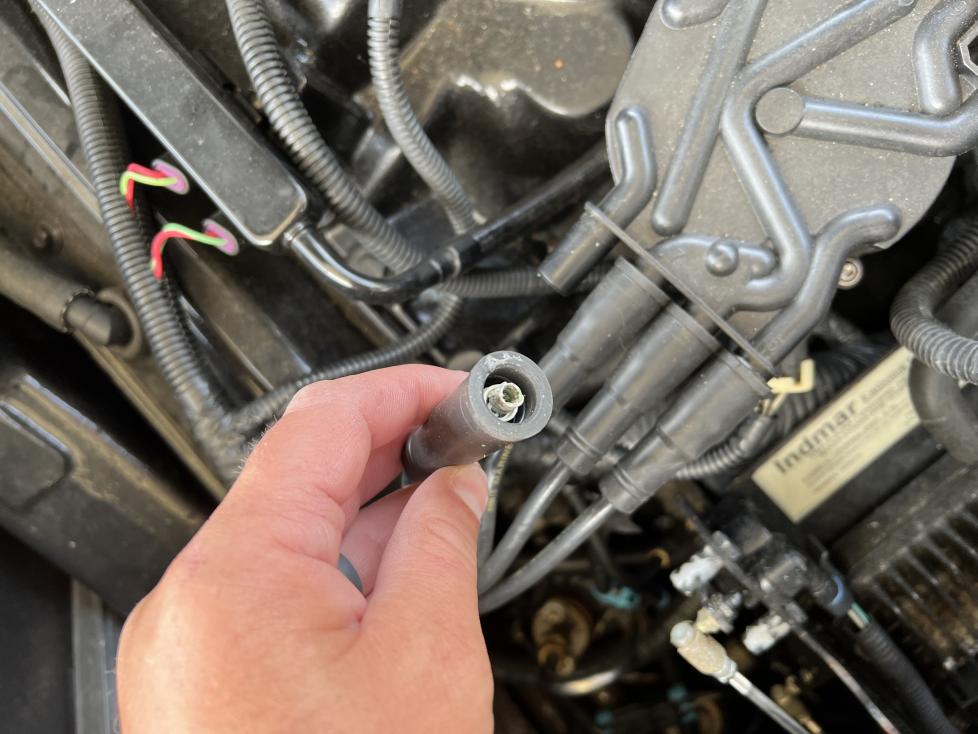

don’t think there’s a misfire but not sure how to confirm easily without mefi scanner (no cheap options i’m aware of). plan to look at the spark plugs and if that may give me clues.
