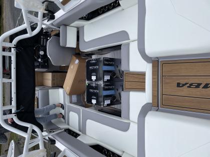

2022 New Max: I am on 17hrs so far and 3 people have cut their knee, toe and ass on the seat gator step down and1 on the back engine lid. Anyone else? and. is there a fix. I have a hard time imagining I am the only one with this problem.

Hak, on the new Max, the gator step on the back engine lid and the observers seat have a hard plastic base under the gatorstep. My guess is that it makes it not flex and makes it a more stable and solid area to step on....which makes sense. The base though is about a 1/4" thick and has a very sharp edge. Clean right angle. If you step on its side, kneel on is, scootch over, etc it seems to want to cut you. We all were saying on the boat that even if that edge was a rounded edge, it would be way better. But with the ChillTech material and how close you would have toe use a grinder, and how much money I spent on the boat, I would never attempt it my self. I am going to try to reach out to my dealer and see what his thoughts are.

Tried my best
Might have some repeats
Run a deburring tool on that.
But honestly SC needs to address that.
I would take thick poster board and tuck it under the sharp surface to protect everything.
Use a fine tooth half moon file and by hand see if you could round the edge. The chilltech is pulling away enough to make this work without damage.
The rounded edge should help the chilltech not get cut or tear also.
I agree with the poster board and file idea. It shouldn't take very much to get rid of that edge to make it not cut you.
Yea that needs to be addressed.
