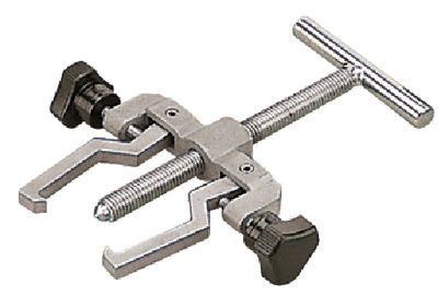

I use an impeller puller made by sea dog to take mine out, gets the job done in less than 5 minutes.Attachment 28675
Sea Dog Line - 660040-1 Impeller Pull SS 2-1/4"-2-9/16"
