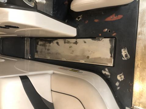

Ive searched extensively in this forum and others to see if anybody else with my boat (2011 Mobius LSV) has done an Gatorstep-Seakdek style update to the flooring. My floor has an large panel that Ive been cautioned on removing the carpet. I heard from a vendor that makes this style of flooring that the panel is meant to be wrapped in carpet since it doesn't fit that well and the carpet fills the gaps. Has anybody in this forum with my boat have photos of a completed flooring change? Available template?

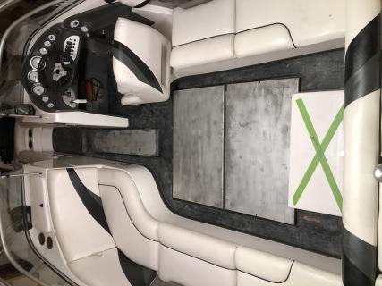

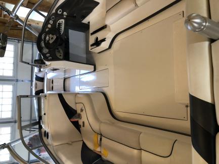

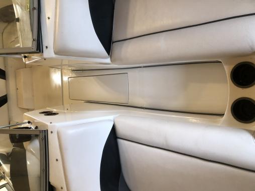

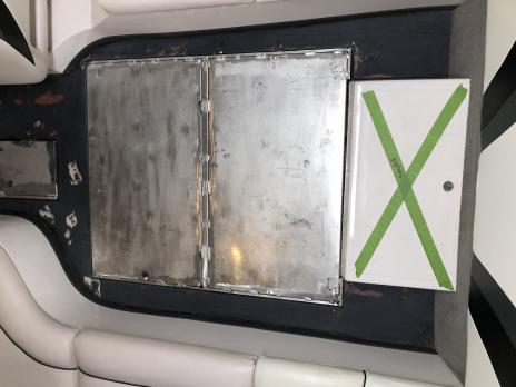

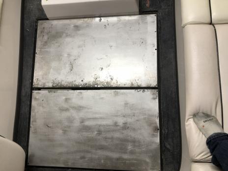

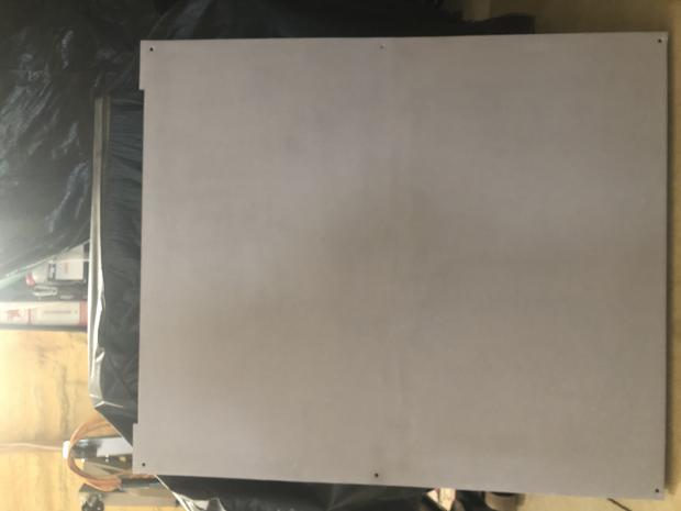

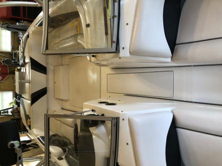

A quick photo of the locker doorAttachment 30297. Please observe the added aluminum angle on the door to narrow the gap. Now both the locker door and floor panel had all the welds ground smooth then sanded with smooth (final sanding 220 paper). Next primed with self etching primer then the body filler another coat of self etching primer then filler primer and finally 3 coats of color. The other part of this project is the boat I sanded and filled imperfections in the floor applied 5 coats of gel coat wet sanded and buffedAttachment 30298Attachment 30299Attachment 30300. After installing locker door and the floor panel complete with screwing panels in place I caulked all the way around the (tank cover) floor panel and the perimeter of the floor with marine grade caulking. Here comes the Seadek installerAttachment 30301

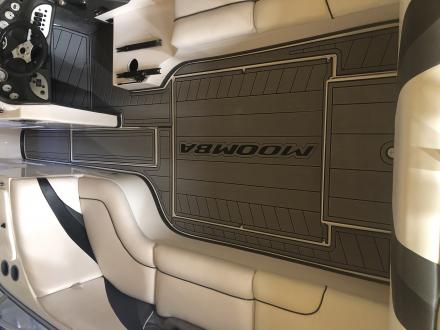

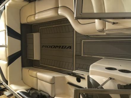

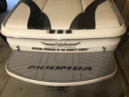

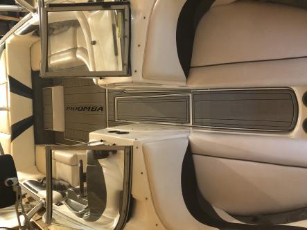

Attachment 30302Attachment 30303Attachment 30304Attachment 30305Attachment 30306 it’s complete and I love the finished product. I have to say my wife had her doubts similar to Jonny Cash’s wife had when she stared at the “psycho Philly Cadillac” and said honey take me for a ride. Seriously if anyone has questions please reach out to me. I can certainly email better pictures. My desire was for the boat to look as if the Seadek was “OEM”
