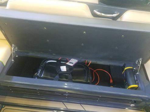

I’m not sure if anyone answered your question but I’m interested in this as well. I would not want to have the seat open out like the example given shows but open up like a normal bench seat would. Hopefully the pic explains what I mean. I’d like to where to get these hinges as well.
Attachment 29174

I did what Murder Max did with his......they open to the front......works great and saves the vinyl when my teems would drop them in. I did get a longer hinge then murder did....for more support.

Third: Hinge like Murder Max did, but longer.
Forth: Obviously both hinged and open

If I am not mistaken, he made the hinges. He made the brackets/supports out of angle iron.
Sent from my SM-G975U1 using Tapatalk
He made the supports for the hinges. The hinges appear to be malibu/axis hinges.
