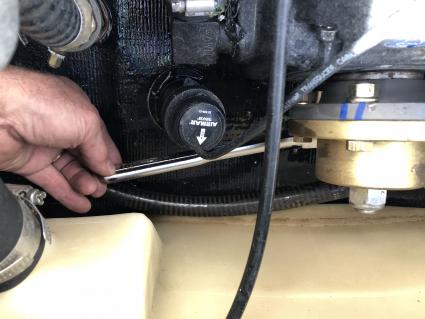

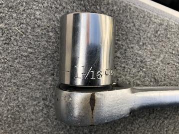

Thanks to RC Hinojosa for those awesome pics from the link above. Just thought I could to help others with a few tips. The most difficult drain plug is the one in the back ( toward the front of the boat )of the transmission/V-Drive. It is reasonably easy if you can use a 1 1/16” socket.
Attachment 27727
Attachment 27728
This is the little devil you are after

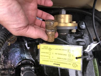

The drain plug on the starboard side of the engine access requires a 11/16 socket. It drains the heat exchanger.
Attachment 27730
Attachment 27731

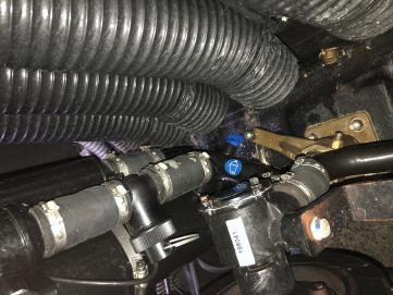

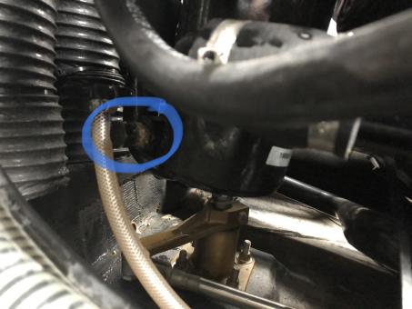

The 2 fittings on the port side are the blue wing bolt and the impeller cover. I drained the blue wing bolt first as it is lower and when I opened the impeller cover I got nothing out. I know the manufacturer recommends replacing the impeller every year so maybe that’s why they have you remove this cover
Attachment 27732

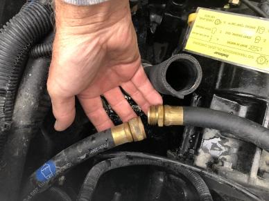

The last place to drain is the garden hose connection under the transmission access cover. Obviously best to do this while you are doing the #$%?¥§! 1 1/16” Drain plug under the trans.
Attachment 27733
