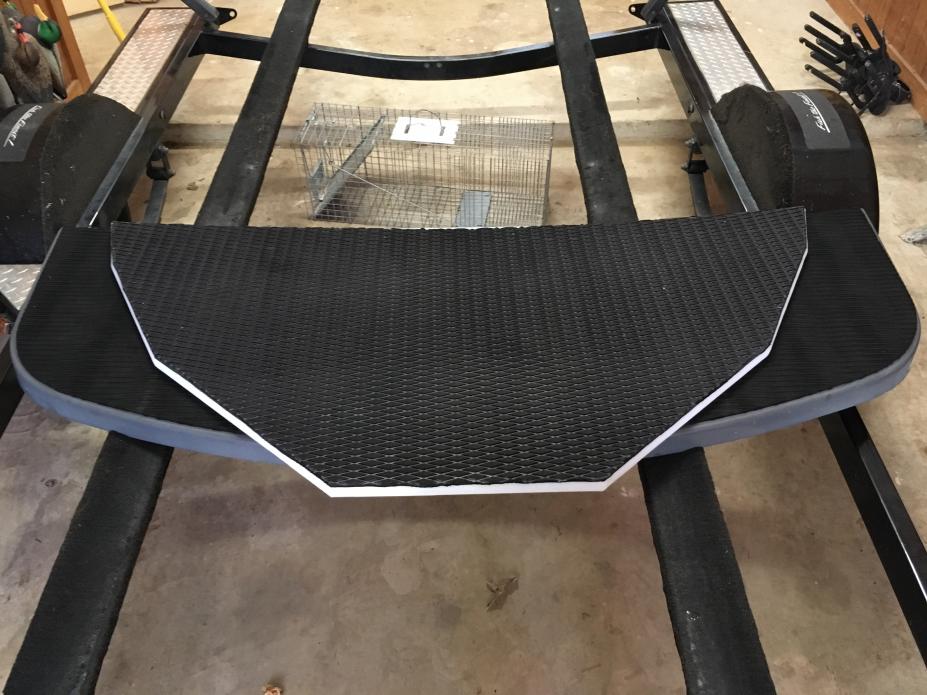

The black pen addition was the estimated shape of the pad I planned to cut and install. (still yet to do...)

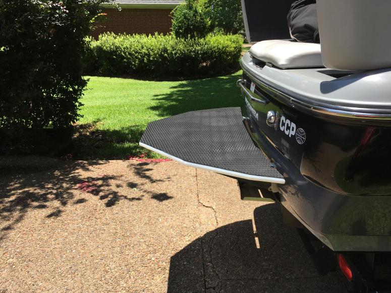

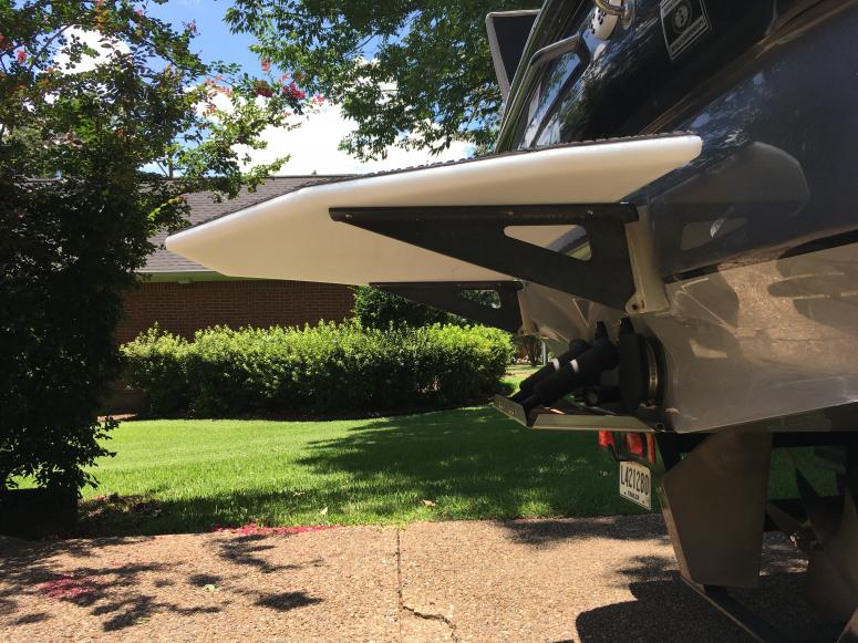

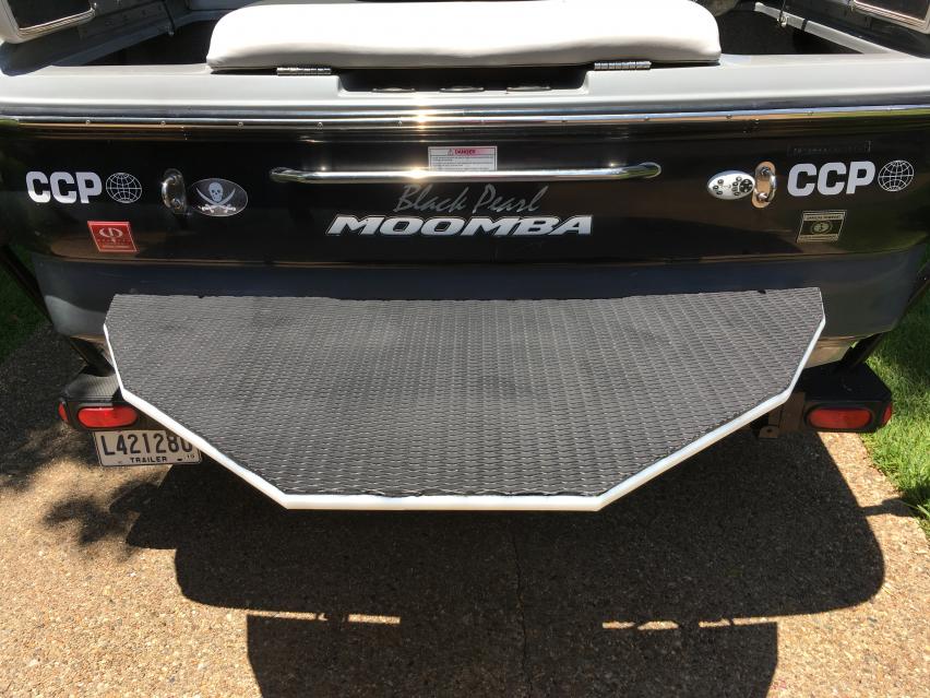

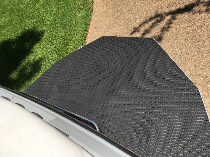

Here is the assembled result:
http://i.imgur.com/LCg0C0l.jpg
http://i.imgur.com/vOWfQ95.jpg
