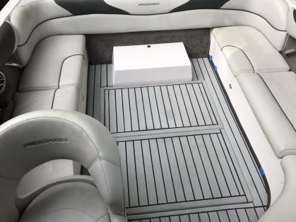

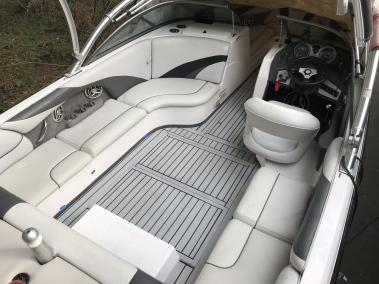

Here’s my 2008 LSV which I recently completed. I’d probably make a few different seam choices if I did it again but I’m pretty happy so far. About 3 weekends of work but one of those was making Mylar templates of the whole floor which I really didn’t need to do. A few small templates are helpful just to help out with radius’s and the driver’s floor.

That looks legit!
I have 1 seem near the locker. You can cut the panel for the hoses, but it's not needed. For pre 06 years you can cover the entire floor with one sheet by removing the floor. For 06 and later you need 2 sheets, trim and tuck the excess hydroturf under the black trim. I use painters tape to make templates for the forward area, then cut.
My boat does not have the black trim around the floor. How is it attached? Is it a solid piece? Is it a flap?
