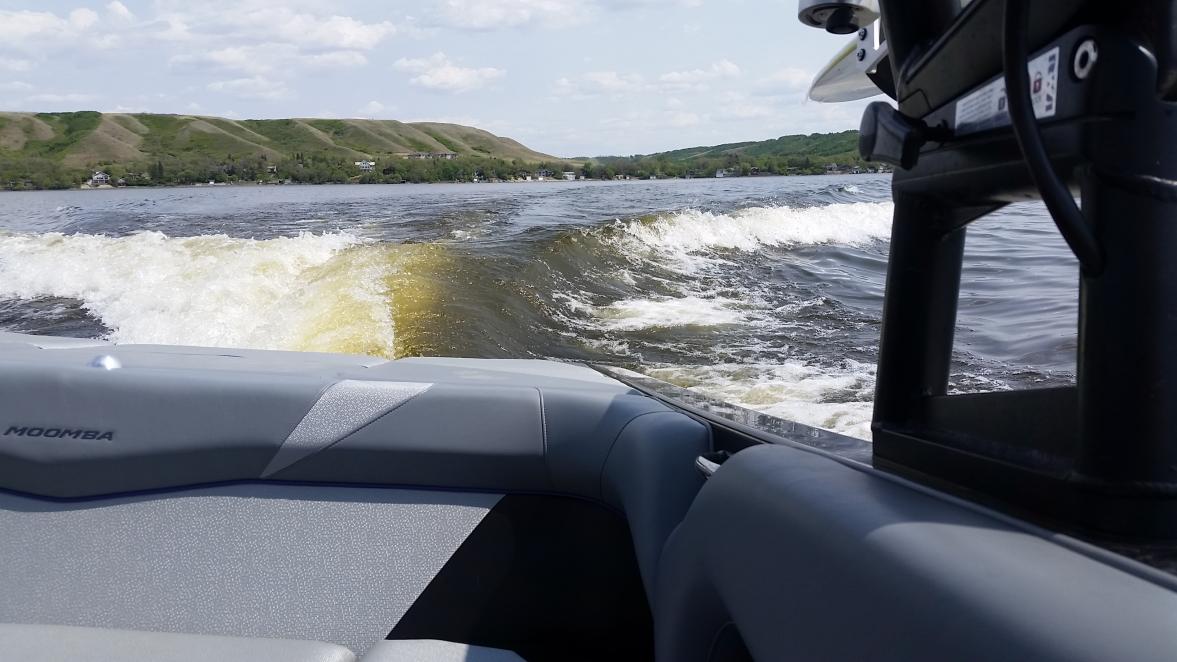

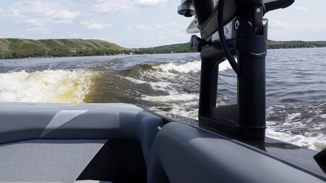

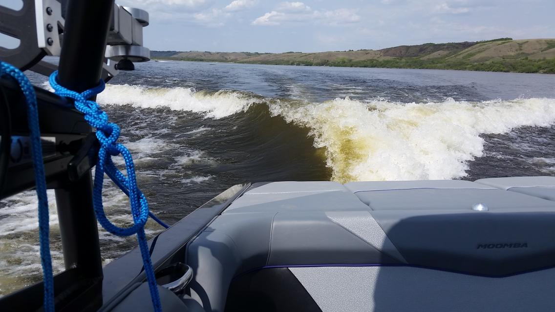

I was tight on time today so I didn't get a chance to fill additional bags. I ran 1100 rears and stock floor tank and 500 ibs. For what it's worth, I wasn't able to ride the wave, just admire them.
Regular wave: 65% autoflow, wake plate all the way up all ballast full except I ran about 80% ballast in opposite locker, speed at 10.8-11.1.***** This seemed to produce the biggest cleanest wave.
Goofy: 85% autoflow, wake plate all the way up, all ballast full except i ran 60% ballast in opposite side, speed at 11.1-11.2.**
I tried weighting the boat evenly at first, but found that I needed to dump some ballast on the opposite side in order to clean up the goofy wave. This also helped the reg wave but it was fairly clean to begin with. Now keep in mind I didn't have any passengers, so just shifting an extra person or two to surf side would likely accomplish the same thing.
Attachment 24215Attachment 24215

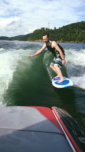

Finally got to surf the new ride. 1100's full plus stock ibs full. 5 adults and a baby all in the cabin. Probably 1000 lbs of human ballast total.
Regular surf: tab at 65% , wake plate 50%, speed 10.6
Goofy surf: tab at 80%, wake plate 50%, speed 10.8
In both cases we shifted one passenger to the surf side. The wave was big and VERY surfable. 2 of the riders tossed the rope for the first time after surfing their boat unsuccessfully for a few seasons. Could definitely use more weight up front though. I will put a 250lb bag under the bow filler cushion next outing. Here is a pic of the regular wave. I didn't get a pic of the goofy wave, as I'm the only goofy rider in the crew. For reference the rider is 6' 210 ish.
Attachment 24285
