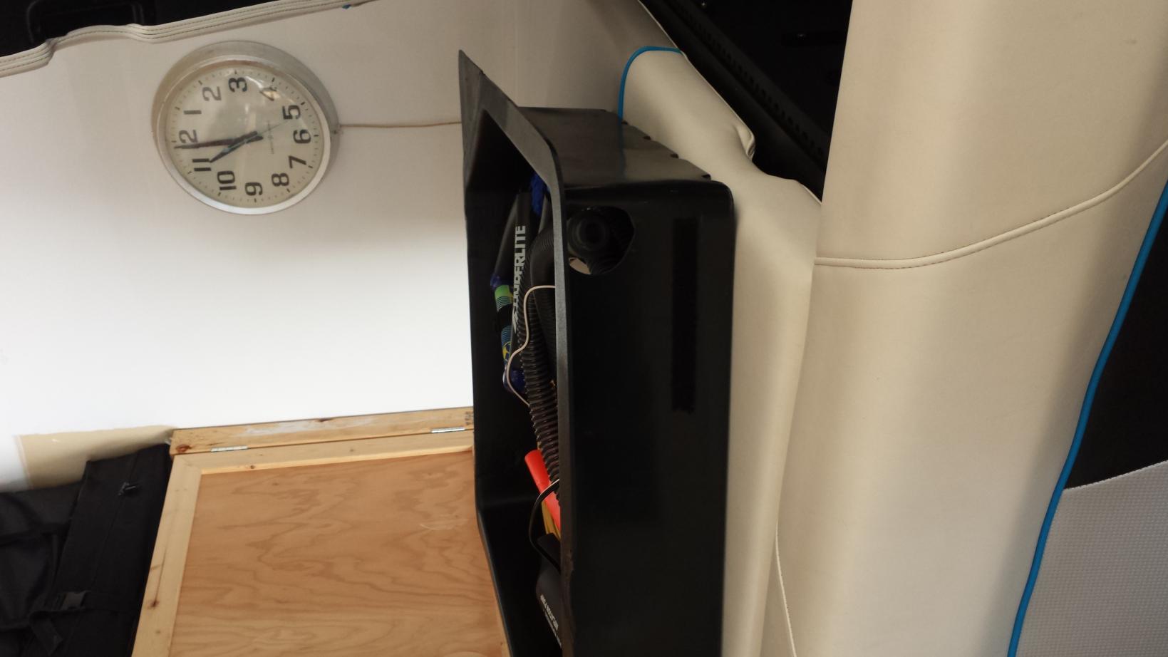

Bringing back an old thread, but my winter mods are coming the end and figured I would post a pic. Of all my mods this one might be the best one as far as convenience. Its nice to not have to dive head first into my lockers looking for stuff.
Attachment 21588Attachment 21589
That's pretty fantastic. what kind of boat is that tray from?
Its from a Malibu. Found in the back of a wholesalers warehouse....Got it for $50. You can still order them from Malibu or Axis for like $200 (too rich for my wallet), but for the small amount of research I did it seemed like a huge hassle. Also, I don't think they come this deep anymore (6"). It did require L-brackets along the engine compartment braces to close the opening like 2" so it didn't slide around. I just attached them at the screws on the Permanent divider sections.

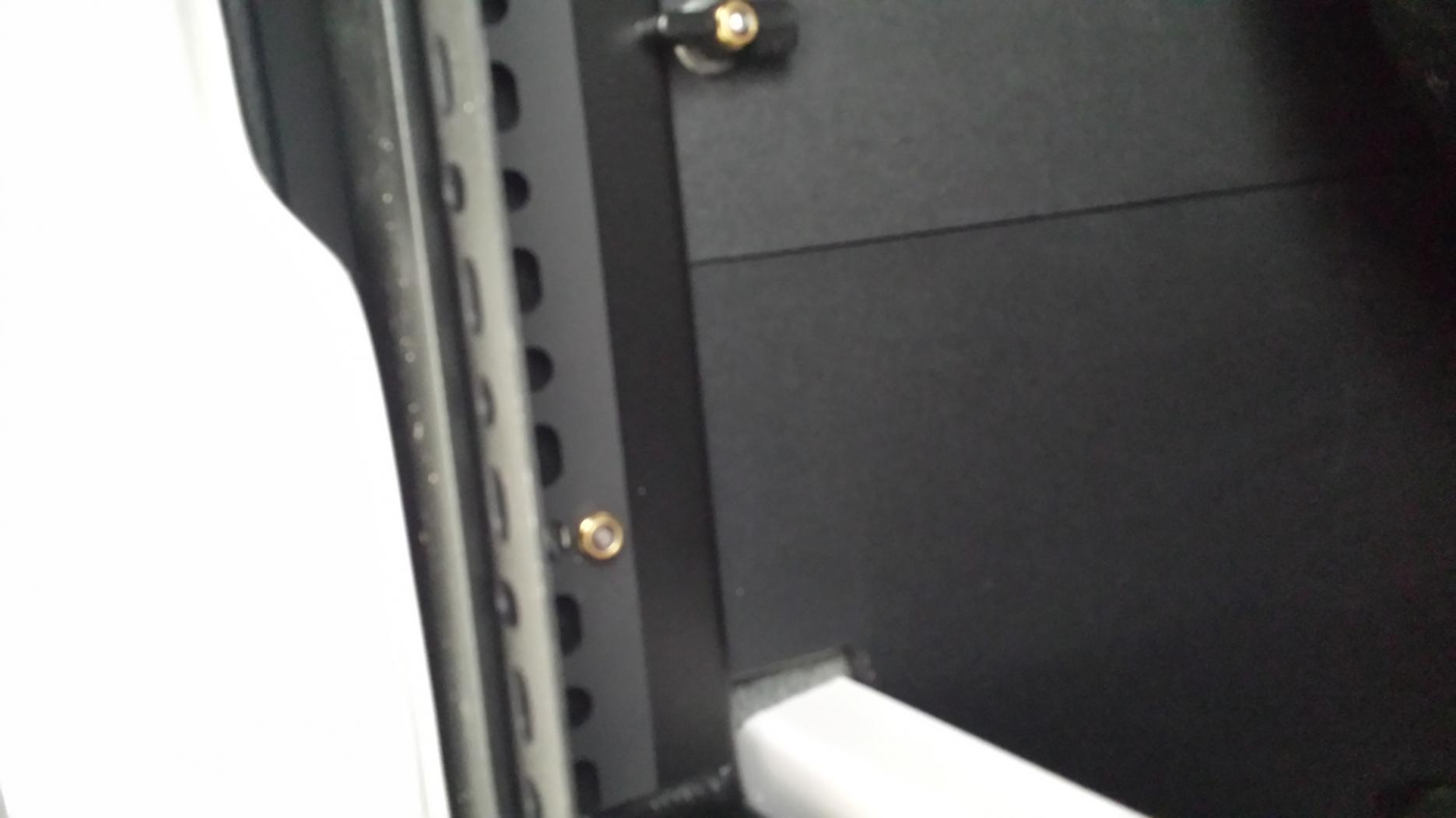

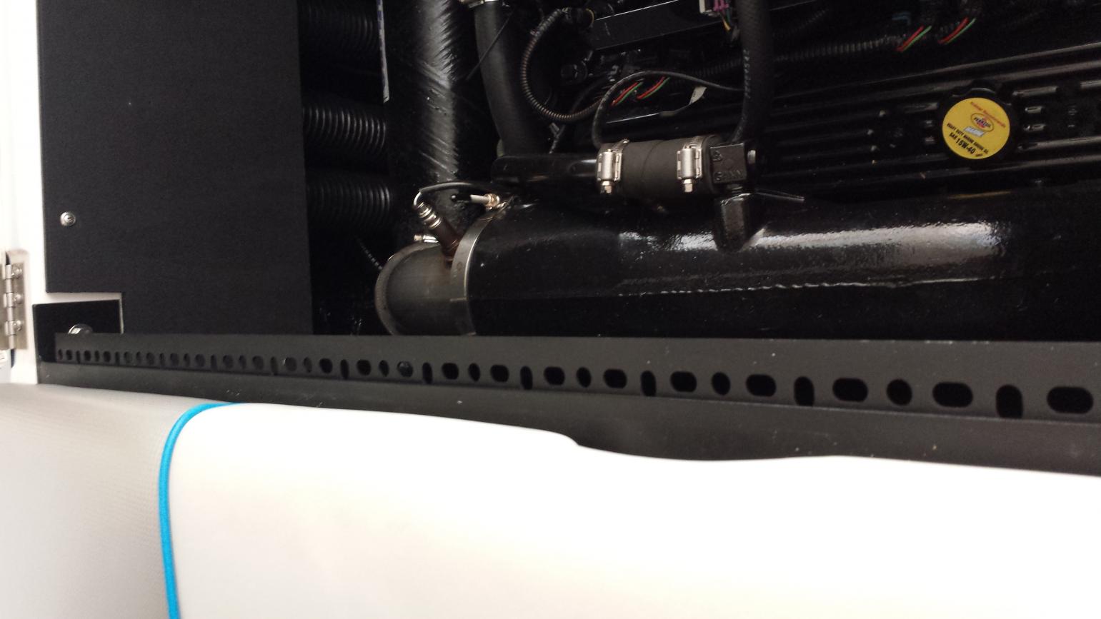

The tray sits on flanges so the "tub" portion is 26.5" wide and my engine compartment is 29" from brace to brace. I got some 4' steel L-channel (can't think of a better name) and cut them down to 3' (depth of my engine compartment) to run the length of the existing braces on both sides. I got ones wider than the engine brace to decrease the width.
Attachment 21635
Attachment 21631
I attached the them using the 2 existing screws for the "permanent" parts of the engine dividers. This brought the width to 27" so there wasn't much play for the tray to slide side to side and fall into the engine. I also used some spacers to push the L-channel out more. I still have access to the removable portion of the engine divider. All the weight actually still sits on the engine braces my L-channels only keep it from sliding.
Attachment 21632

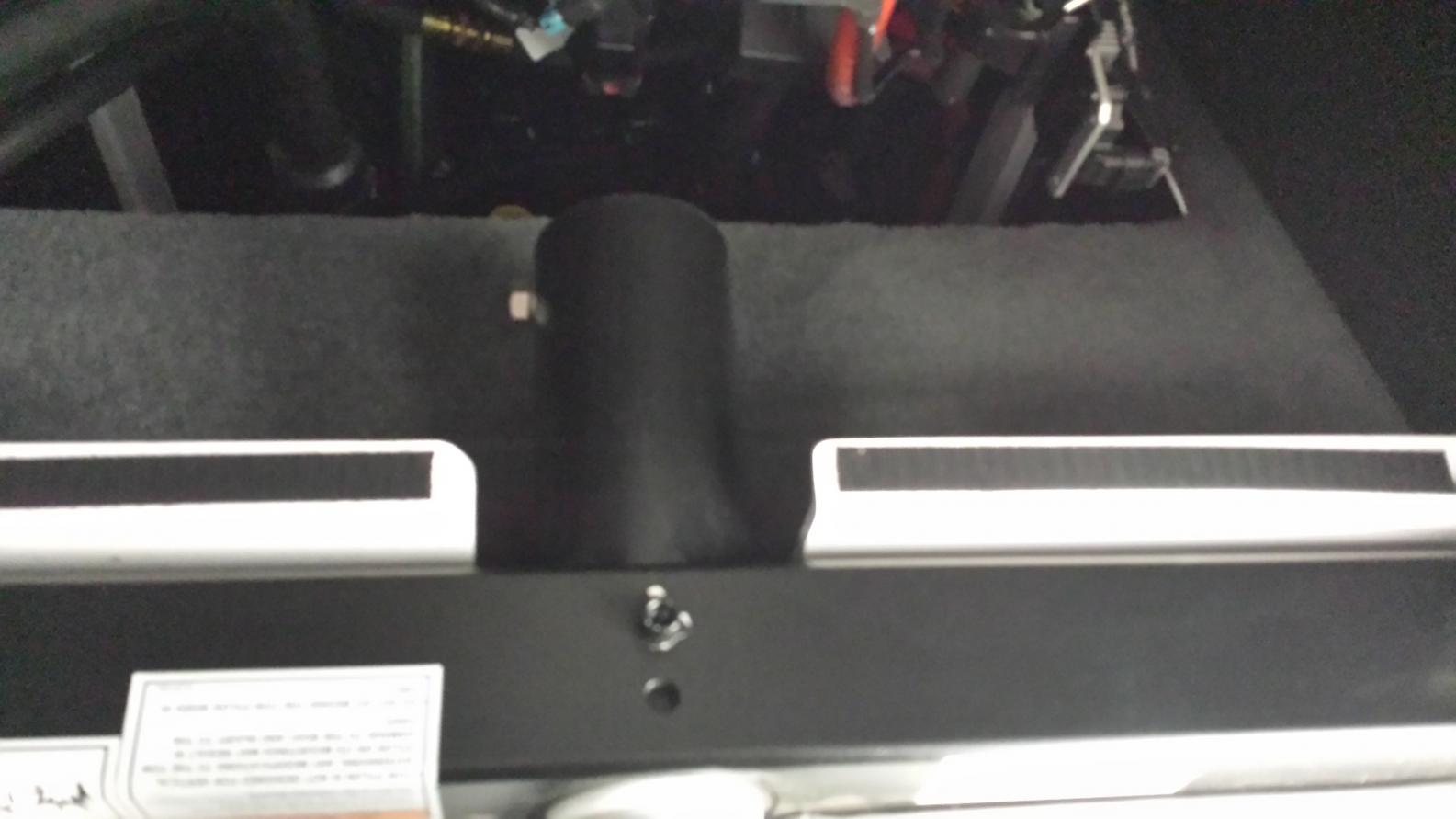

I also placed commercial strength Velcro along the back bench wall on both sides of the ski pylon to keep it from sliding front to back, but honestly the weight of the cover would hold it too.
Attachment 21633

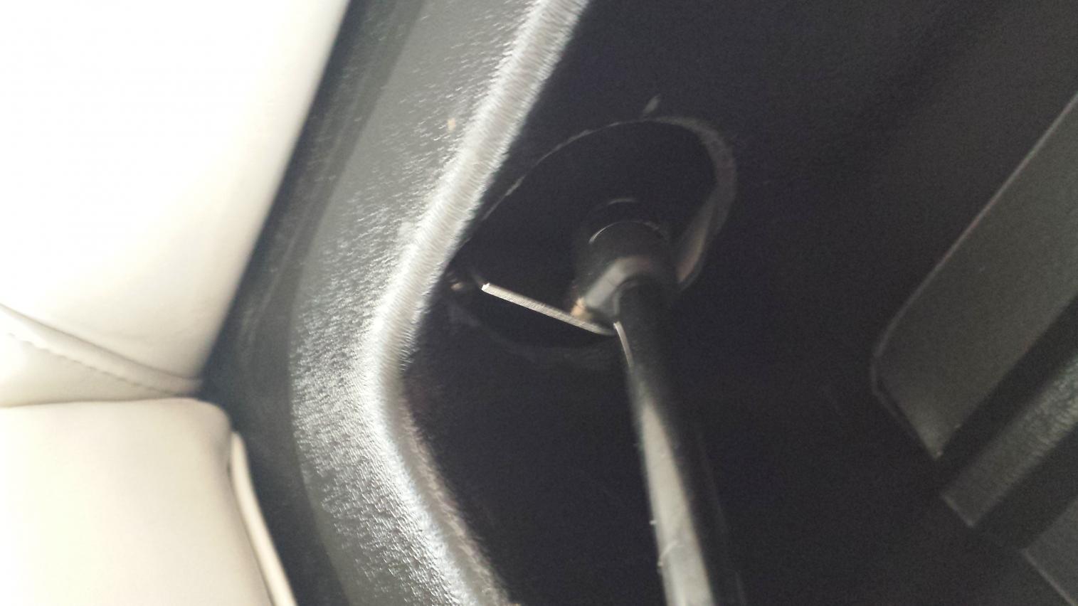

Last I just made hole for the cover hinge to attach. I may still cut a slot through the flange so I don't have to pop the hinge off to take the tray out, but really I never need to unless I am doing maintenance in my garage.
Attachment 21634

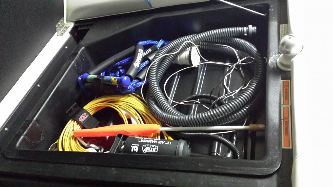

He keeps life vests, dock line, surf rope, flag etc. It's nice to not be able to dig to find stuff when you forget your ballast is already full. Seems like I always forget my life vest and have to muscle it out between my bag and engine panel haha.

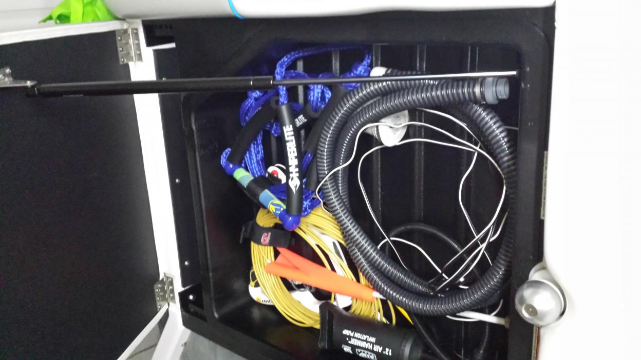

this is my setup on the rear lockers. it's a small and a medium. works great. on the port side, I have the surf rope in the medium and I have docking lines with carabiners in the small. on the starboard side, I have the wakeboard line in the medium and a handful of ski gloves in the small.
https://lh3.googleusercontent.com/-V...418_171730.jpg
I also put a small cargo net on the underside of the starboard seat cushion and that holds coozies and cheap "boat sunglasses", I put another small on the back of the observer swing out door and that's been home to a couple of kitchen size trash bags and a long 3.5mm extension cord to link up with another boat via the WS420sq. Lastly, I have another small that's above the driver's floor cupholders. that one has a couple coozies for me and a pair of light gloves and a beanie.
