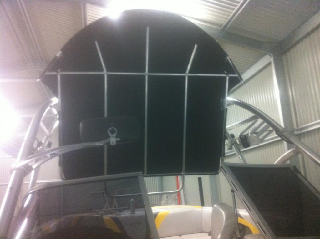

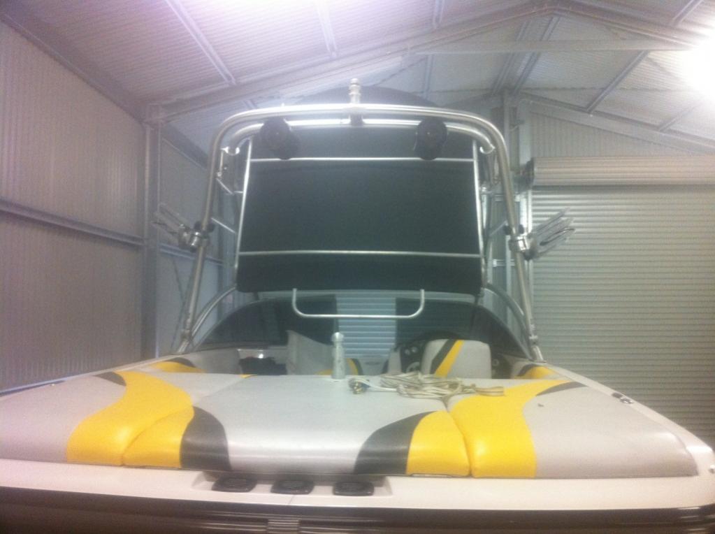

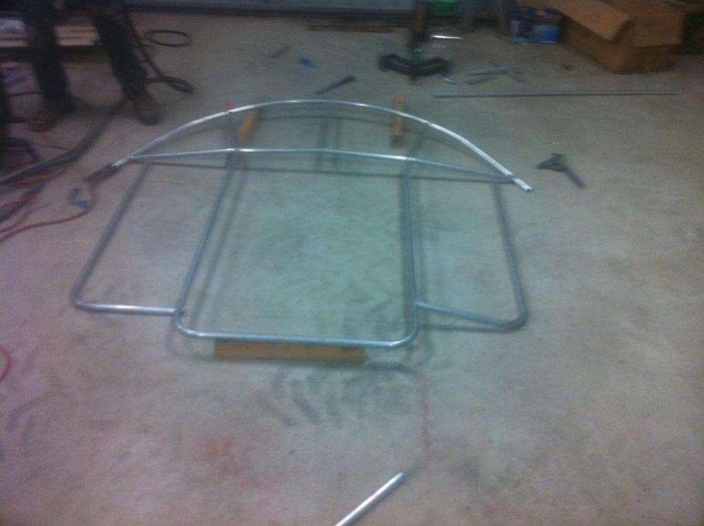

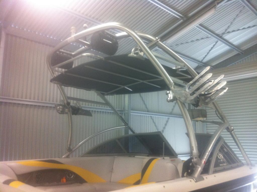

Gday from Down Under. Like a lot of guys on here, I love the look and functionality of the Z5 cargo bimini ..... just not the price tag. So here is my attempt at building one. It has all the functionality with the racks on the top, the swivel, the shade and solid construction, but not the pazaz. I built it out of 1" aluminium tube. To get the curve at the front of the bimini I scribed an arc on the floor at the radius I wanted. Then I nailed some timber blocks to the radius and bent the tube around the arc. I have access to a pipe bender so was able to bend and weld the rest of the bimini quite easily. As for the cover, well I cheated a bit in that regard as my wifes brand new bernina sewing machine is off limits. I had a local upholsterer cover the rack in heavy duty sunbrella.

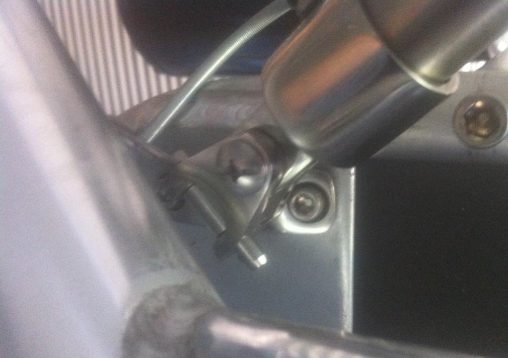

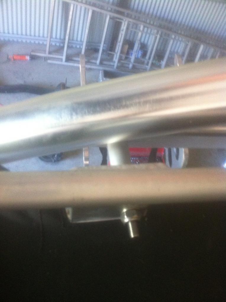

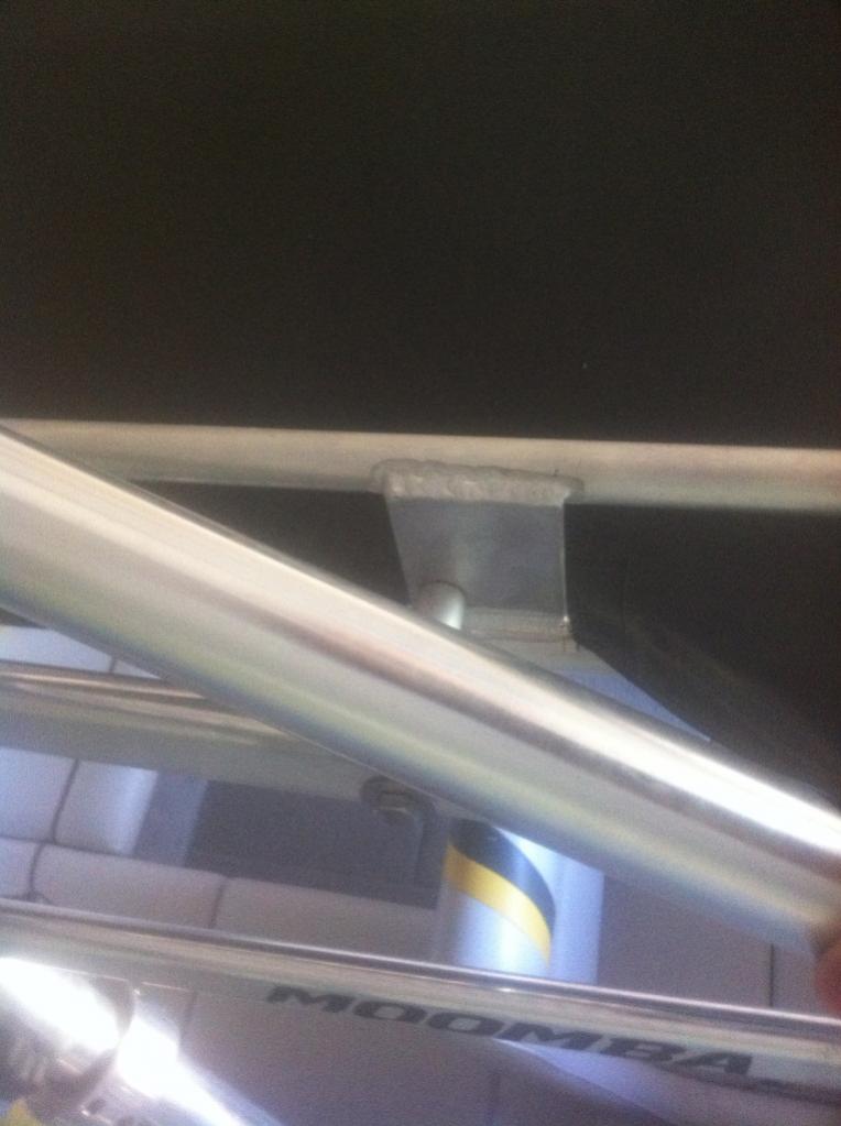

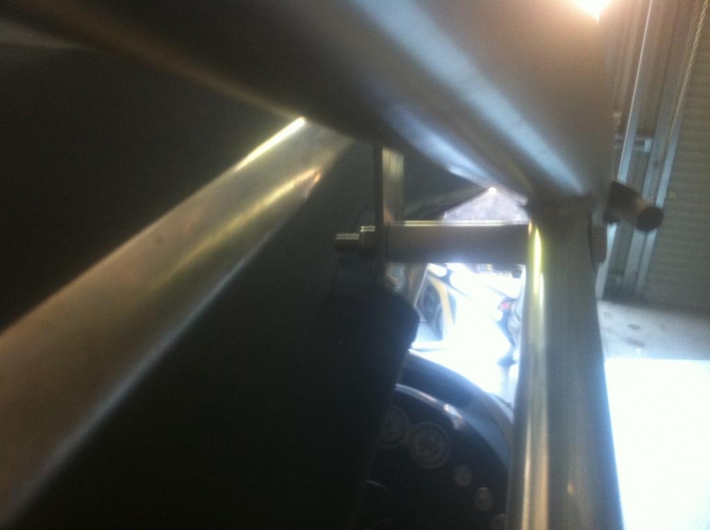

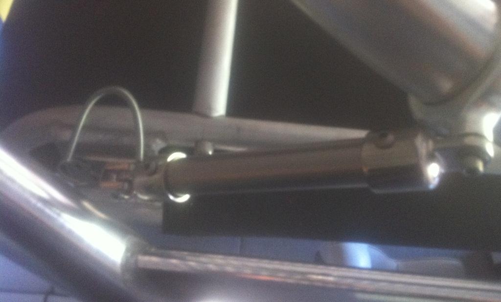

As for the mounting, I simply bolted through the elongated tower tube and through the bimini itself with some 1/2 inch stainless bolts at the front which allows the bimini to pivot. The back is held in place much the same as the factory Z5, however I use two pins rather than the ball and socket system of the Z5.
