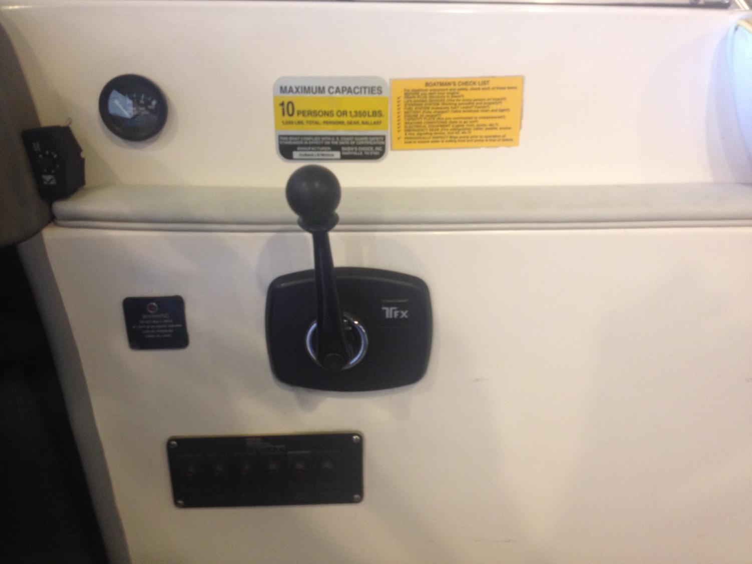

Not much to look at yet;
Before the switches were in a horrible location, never did get used to them, never could remember which was what and what was on or off as I couldn't see them.
Attachment 16904

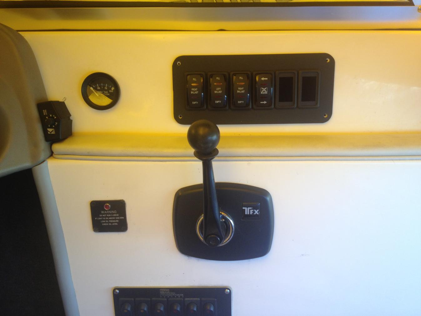

This is where the new ballast switches are including a new switch for the third X-Over reversible pump between the back two bags. Got two more future switch spaces, probably going to add some docking lights on one of them.
Attachment 16903
Eric.

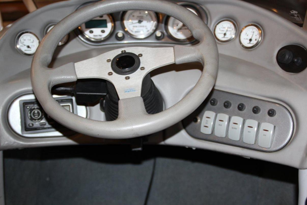

Where did you get the plate and switches from?
The plate is just fabbed from black sheet plastic, I will make another one to block off where the existing switches are. I also relocated the ignition switch to a piece of black plastic when I did my stereo install.
Attachment 16913
The switches are from the good folks up in Oregon at WakeMakers give them a call.
I am also going to have the guys at OTRATTW (I LOVE that name!) make some new covers for my existing switches on the dash.
That I am looking forward to seeing since I have the exact same switches.
Speaking of that, better watch your elbow on the new plate you made above the throttle. You may get some of the "what's wrong with the wake" or "how come the boat's leaning" when they get bumped accidentally!
That is definitely a possibility, but at least I would then have an excuse for any less than stellar boarding, though during this off season, I bought a new '12 model board and the salesman (some kid with a flat brim hat that could be my son) told me I should be boarding like the pros with it.
And if I do hit the switches errantly, at least now I will be able to see them and know which one is what! I have a theory that the guy at Moomba who designed the stock ballast switch location was some old skier who didn't board and hates how we look jumping wakes with loud stereos!! Jealousy is such an ugly emotion…
