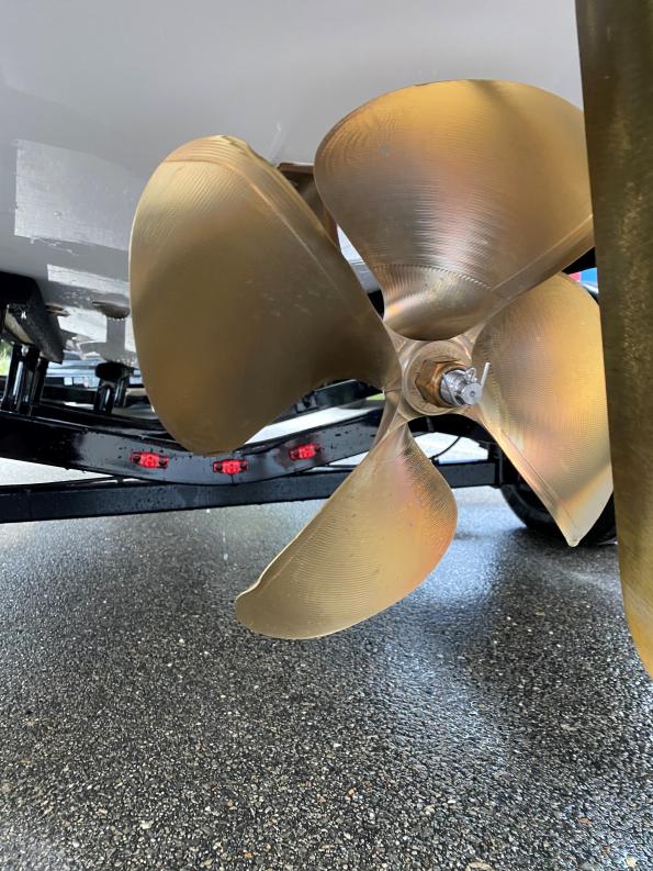

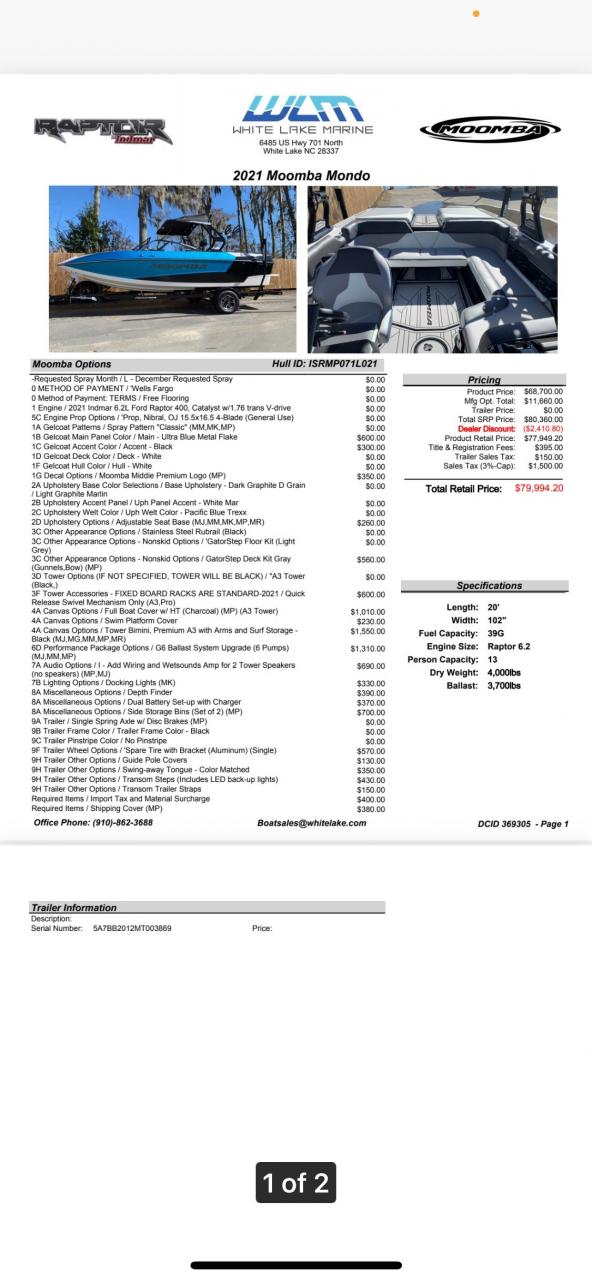

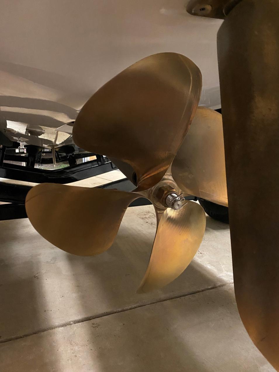

I just got a 2021 mondo and I can't get this thing to make a wave to surf on. It's really me and the wife on the boat but it will not push and keep me in the pocket. We are new to this but still should at least look like the wave the guy from wake9 on youtube had when he reviewed the boat. We had 4 people on it yesterday and they knew how to surf and couldn't get the wave right. I ordered 300lb of lead so I can add to the bow since that keeps on saying it needs to come down to 9.5 pitch. But do I need to upgrade my prop? I have the general use one I was going to get the speed/surf one from Wakemakers and use the general use one as a spare. here is the build. should I buy anything else?
