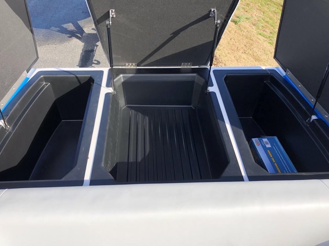

I've been rubbing on the design of a drop-in bin for V-Drive lockers that can be manufactured from flat ABS sheet by bending on a press brake. I was inspired by the new bins in the Moomba Max (and current Axis offerings), but molding - or even thermoforming - requires tooling specific to each design. My approach allows for nearly infinite configurations at no tooling and minimal design cost. I'll probably make a few prototypes next week. I'm looking for suggestions and gauging interest from the community.
The idea is to keep a common design and only modify length/width/depth/lip dimensions. Cutouts could be added easily for gas struts or latches that need to be dodged. 1/8" or 3/16 textured ABS plastic cold bent on a press brake then seams secured with plastic rivets.
