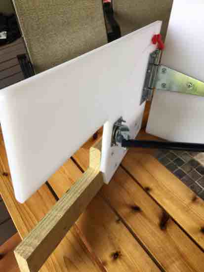

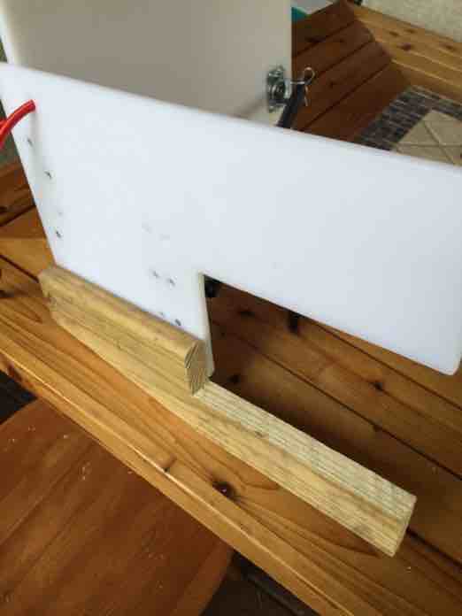

Transom board: Cut 9 x 20 inches (rounded boat side edges with roundover router bit) a notch cut out is used to wrap around the ski platform bracket. The entire back plate (transom board) is centered off of notch cut out). My cut out was 3 x 5 and 7/8 inches. I drew a line all the way across so I could line up everything to include the gate. Hinge is mounted with 5/8 inch x 2 inch carriage bolt (carriage bolt is recessed into boat side of plate slightly under flush to prevent scratching) and on centerline with hinge pin extending past the outer edge of transom board ( I aligned the inside of the hinge pin with the outside edge of the transom board).

2) Flip the transom board over and use a spade bit larger than the head of the carriage bolt (7/8) and drill a recessed hole just a little deeper than the head of the carriage bolt. Once complete, then drill the 5/8 inch hole all the way through and place the carriage bolt in place ( I had to hammer it in). This bolt head must be just below the surface of the boat side to prevent scratching your boat.

7) Attach gate to transom board hinge (align the centerlines off of the transom board and the gate). Attach the gate making sure that the outer transom board hinge pin is on the outer edge of the gate (you should have a gap that is the width of the hinge pin.

8) Turn the transom board over and countersink (use a 7/8 spade bit to recess threads on boat side of transom board). Countersink about 1/8 inch deep). Once complete, drill 5/16 inch hole to insert threads from boat side. Heat up threads (this will melt the HDPE around the threads) and press in so the threads are slightly deeper than than the back of the board. Drill the rear holes out the same way you drilled the rear centerline hole (slightly smaller than a 5/16 hole and tap/thread).

Gate: Cut 12 and 1/4 by 20 inches with center cut at 19 inches with a 25 degree inside miter cut
I cut a shallow V out to extend the edge in the water and allows for flipping the gate over to the other side and still keep 20 inches in the water
Remove wheel from the caster wheel and mount the caster wheel frame to the centerline of the gate (approx 2.5 inches from edge). This is used for your support brace
Hinge is hard fastened to the gate (will not rotate) with carriage bolt and # 12 screws on centerline. The hinge pin on leading edge
Brace: Cut cane handle off (length of cane should now be 16 and 1/4 inches long. Note: Make sure cane is fully extended before cutting handle off. Drill hole in both ends of can (perpendicular to the cane's push button) and approx 1/2 inch from ends. Attach fat (handle side) of cane to the Gate with #6 by 1.5 inch bolt with locking castle nut (ss). Attach smaller end to the transom board side with a clip pin
Note: I added a rope handle to the transom board to ease removing and handling (Two tapered holes (5/16 in upper outer corners) with a rope and knot. Place the rope through a washer tie a knot and tread through from the boat side and back through the other side with a washer and a knot. Make sure the washer is slips into the hole but does not pull through.
