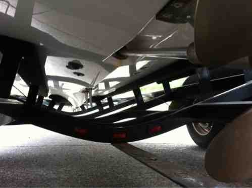

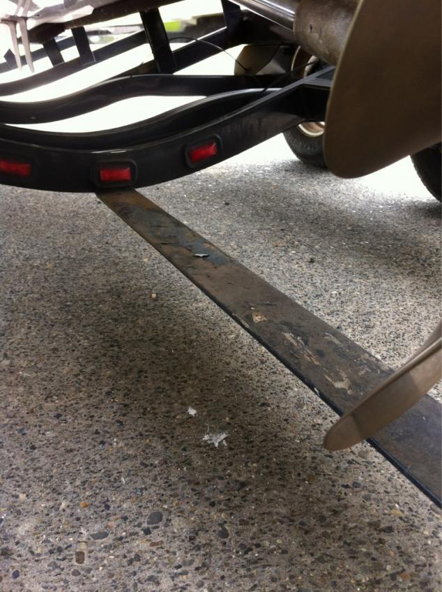

Curious as to where everyones driplessis T'd in? Mine was off my exhaust quick connect. It started leaking again so I T'd into the thermostat housing to rear cat exhaust dump hose as this line stays cool and was easiest. There was not enough clearance between tranny cooler drain and alternator to come off there. So far the dripless is dripless as the vesconite housing is not expanding due to hot exhaust water
