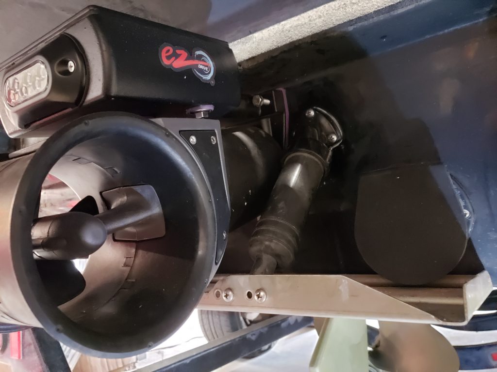

3500-4000 for the kit, 5-6 hours install labor plus travel expenses.
There is not a large installer network yet, so they send a install tech to install it on owners dime.
If that is way off base, my apologies, but I have pieced it together over reading other forums.

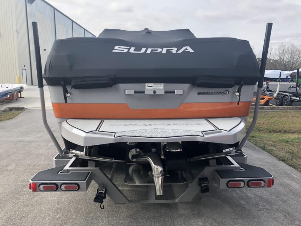

A couple performance issues noted were:
1) surf pipe exhaust bubbles interfere and cause thruster cavitation, my understanding is this is the reason Supra installed two thrusters farther outboard of the surf pipe.
2)The EZ drive forces you take your hand off the throttle or wheel to operate.
Nautique’s system uses an exhaust bypass when it’s factory system is in use
Nautique system is integrated into the steering wheel input.
Supra has a twist knob on the throttle so you keep your hand on wheel and throttle for seamless integration.
