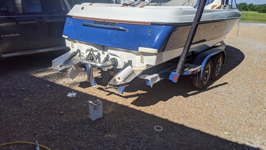

That’s a gigantic actuator for 2.25”! Weird looking. Seems like it’s as long as a Lenco body is for the 4.25” version.
What’s the actuator look like In the up position? Not familiar with Bennet at all. Looks like it’s mounted exactly like a Lenco would be—really far outboard on the plate. I would have expected the opposite.
Are the plate dimensions similar?
The tabs are same basic dimensions as the GSA tabs
They are Bennet Bolt actuators, their newer line to compete with Lenco.
Nice thing is lifetime warranty so no more having to buy new lencos every few years lol They warrantied one that I broke with a misalignment without question.
Only downside is the bottom mount is plastic where the lenco is metal.
13.75" length 2.5" stroke. (I misspoke on the 2.25 if that 1/4" matters to anyone :D)
https://forum.moomba.com/attachment....3&d=1597941037
They make kits to convert lencos over so I assume they are the same dimensions essentially, but the bolts are larger in diameter.

He said he has 30 up and 14 down. Not sure what my up was, looked similar to his, and I had it set to 18 down - too much as you noted, 5 was perfect. But not too different than what he had, and adjustable depending on which mount hole was used, and where I mounted the lower mount. I suppose you could get significant up and 6-8 down with a short throw actuator.
You can see in this pic of the smaller tabs I made as well, I could get between 12 and 30 down depending on where I placed the lower mount. https://uploads.tapatalk-cdn.com/202...bbc25afea0.jpg
Yeah as you know a small movement in the actuator mount can have a large effect on the deployment, looks like on your small tabs about an inch of placement difference yielded 18 degrees of change.
Through a lot of trial and error on placement for both ends i was able to get the extension and retraction that I wanted with the 2.5" actuator.
It would have been easier with the 4.5" version but I wanted to give the bennetts a try and they don't have the long throw versions.
