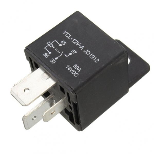

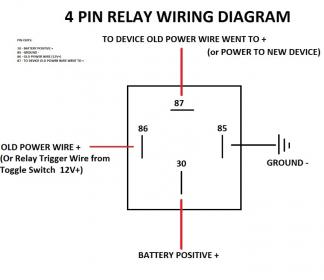

I'm not running 2 per pump but I am using relays. It's pretty easy to setup and wouldn't be hard at all to connect multiple relays up in parallel like you're thinking. The only thing to consider is if you really want 5 pumps running at one time. I certainly wouldn't want to do that on battery and the stock alternator may not be enough so you'd be somewhere in between...
