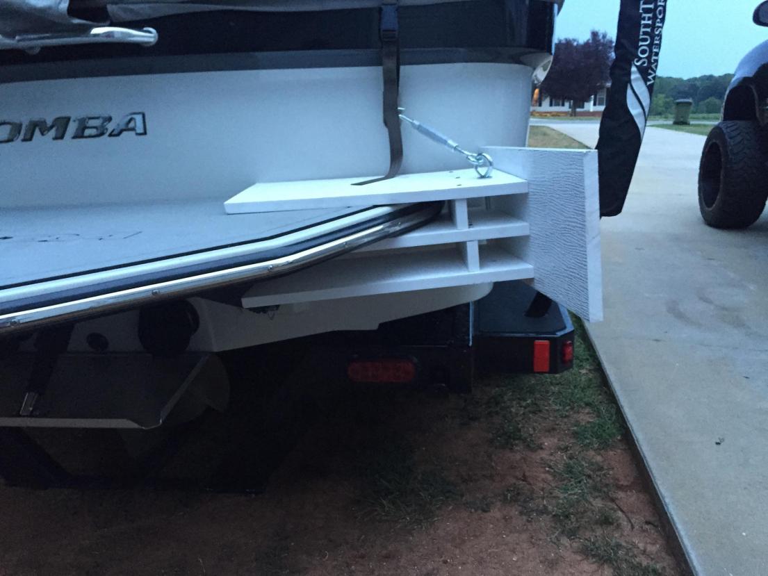

http://images.tapatalk-cdn.com/15/08...7aa86c292b.jpg
Strapless... :eek:
Strapless... :eek:
I just use one turnbuckle
A friend of mine made this ghetto gate for his 12 Mojo. I thought it was pretty clever to make it this way so you can use it for both sides. It might add some structural support as well. We tried it out last weekend and the wave had awesome push but it wasn't very tall. Wake plate was up and the rear 1100s were filled about 90-80 and the center was full. No passengers. I have a few extra sacs to bring along this weekend. How should we weight it with the ghetto gate?
Now I plan to make one for my boat!

My LSV version 1 is above, am revising into version 2 as we speak. I found the best wave overall came with all bags full. I run 800lbs in each rear, 400 in the floor and 550 in the bow. I was at least 90% in all bags. I now have a few extra bags to play with but have not added them in yet.
waiting to see Version 2....sooooon.. have my HDPE ordered and waiting arrival, then build build
As much weight as possible with the boat fairly level front to back. A little bias to the surf side. Keep the top of the gate just above the water line when moving.
