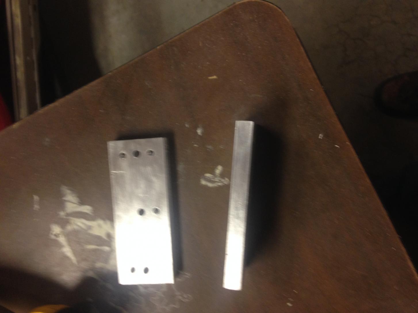

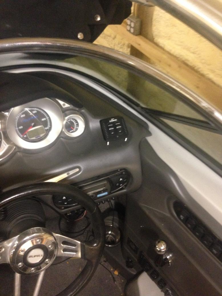

So I got at little time to work on the boat.
I got the aluminum blocks made and ready to be installed on the boat.
I also drilled the dash and mocked up the control switch.
Next time I work on the boat I get to do the fun part start drilling and putting screws into the hull of the boat. the first hole always a little nerve racking but it all down hill after that.
The electrical is all figured out should take me about a hour to install and finalize.
here is a few pics.
Also on a positive note the interior is suppose to be done next week.
Attachment 21447Attachment 21448Attachment 21449Attachment 21450

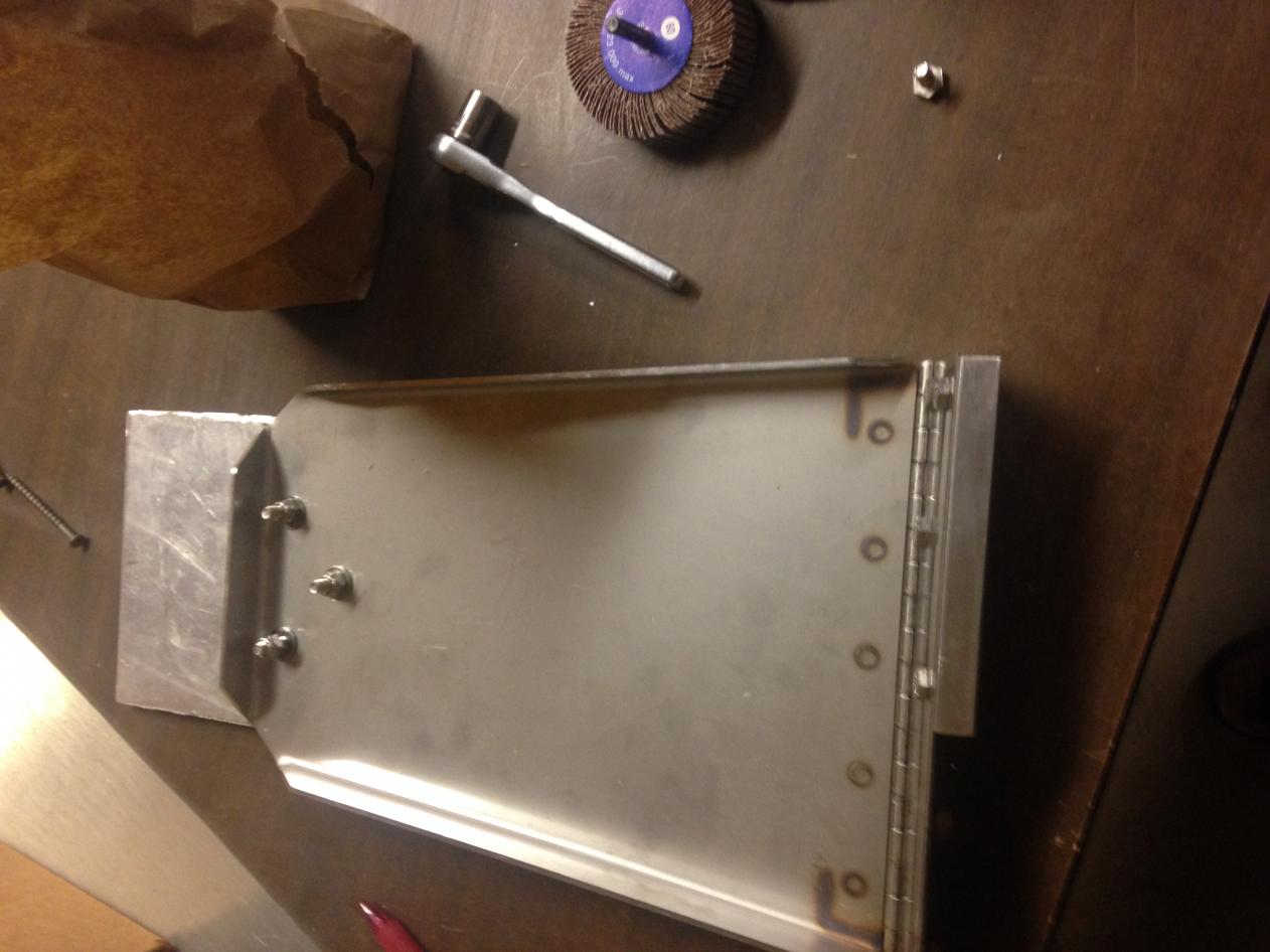

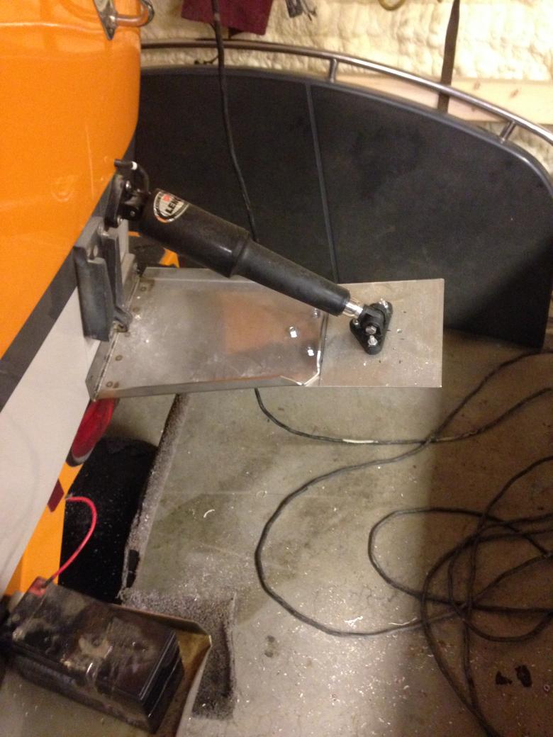

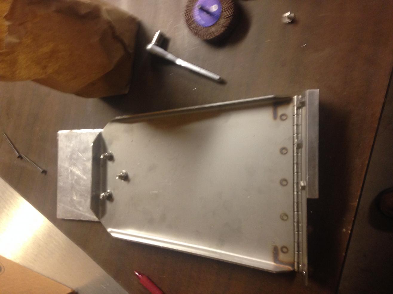

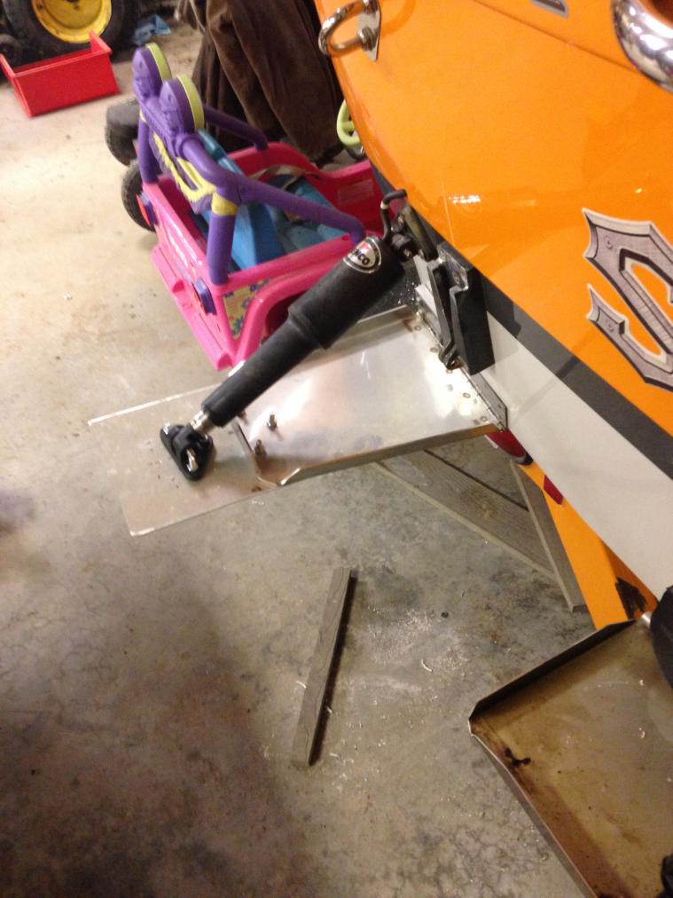

4 Attachment(s)
I got the tabs all installed now only thing left is to pull it back off and caulk/glue everything and reinstall everything.
All the wiring is ran and the controller has a home. but I need to install the interior before I mount it in its final resting place.
I currently have aluminum plates add to the trim tabs that will be replace with stainless but we first want to water test. I would like to put some fins on the bottom of the stainless plates but want to test everything with aluminum (I have a bunch of pieces of aluminum to play with but no stainless on hand)

2 Attachment(s)
If i could make a suggestion it would be to move the plate that you have added to the tab to the top. If water gets between the two it could possibly bend it.
I can see that you added increased length to your tabs. I'd suggest playing with different shapes that utilize more width. Try some shapes that have been used by other manufacturers, like the shape of the autoflow or the shape of the Centurion Quicksurf.
